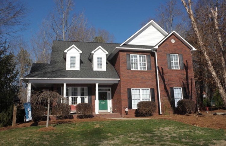

Since you guys sufficiently scared the shit out of me from building a house...bought this one instead. 5bed/4bath 3000 sq/ft, 3 car attached. Was a much, much easier process.
