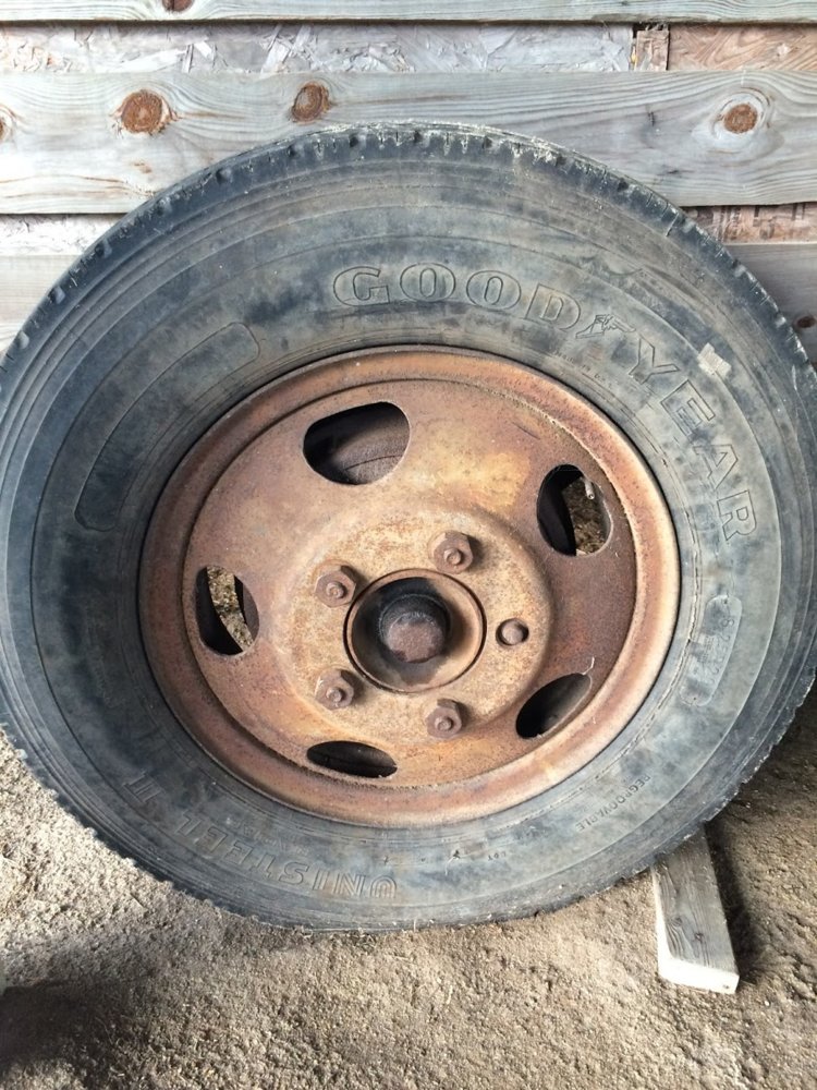

My FIL needs new tires on his corn trailer. All I know it is that is has some very old axle/wheel/hub combination. Looks like it's from the 50's.
Problem is that it's a split ring wheel and no one around here wants to deal with it any more.
I'd like find something in the 19.5 or 22.5 family to get it going.
What could be options?
Trailer holds about 120 bushels of corn about 6500 pounds. Travels less than 10 miles per year.

Whats the bolt pattern? It looks close to a 5x5.5 which rims are a dime a dozen for from an old Dodge/Ford/Jeep. Most will be 15s but you can occasionally find 16s. Either way that would probably be your cheapest option.

OK took out the tape,it's 5.25 center to center,with the holes being 2 inch across. These are dual rims. Forgot about that part.
On a 5-lug, you measure from the center of one to the outside of the one across, since they're not directly across from each other. That should get you the diameter. Sounds like it's 5 on 5.5, though. Also sounds like that axle is a lighter duty than you originally thought! Probably out from under a half-ton vehicle.
