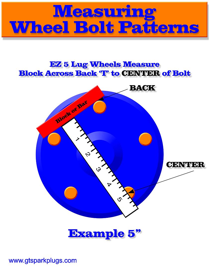

How do you determine the radius of the circle in which the middle of each lug hole passes through?
Then what are the chords from one point to the next?
I can't find this info even for a 5x4.5 pattern.
you mean like this:
Yea but with more accuracy
Come to find out the 5x8" lug pattern has an 8" diameter. And a 8x225mm has a 225mm diameter.
Guessing that's why they give it in those terms.

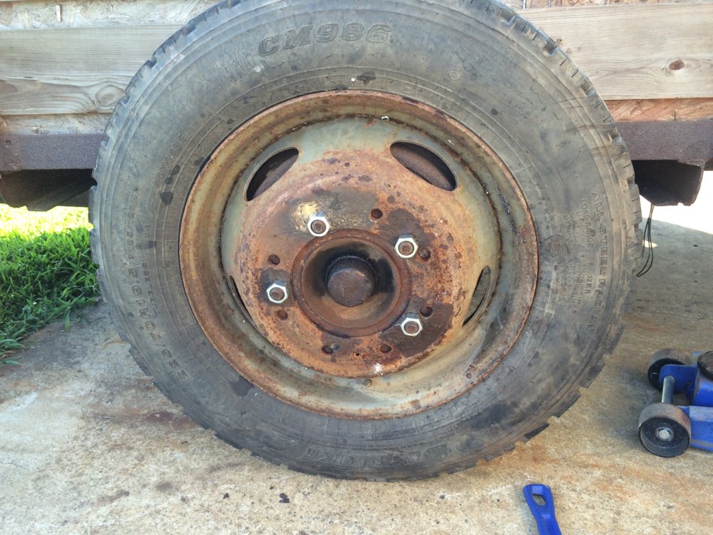

Got it all figured out to redrill the lug holes. The studs are 3/4" should the holes in the rim be 1/64 bigger or 1/16 bigger.
Depends on the shank diameter, but try on size first, and if they won't seat, try 1/64" over and if they won't seat, then go bigger. The ones I've done before were in aluminum and I just did them on size. Stepping up 1/64" should be doable freehand with a drill.
Redrilled one wheel just to make sure it would work
Now I just need to drill the other one.
Edit: one stud was already broke.
So predictably this has only gone ok. New wheels are drilled and fit. However old wheels were lug centric and new wheel is hub centric so it's no centric at all right now. Max speed was 20-25. Has anyone used a hub centric adapter to align this type of problem.
Two other questions:
Does the taper to a lug nut offer any type of locking strength or is it mearly for alignment?
How much weaker is the rim now that it has five additional holes?
