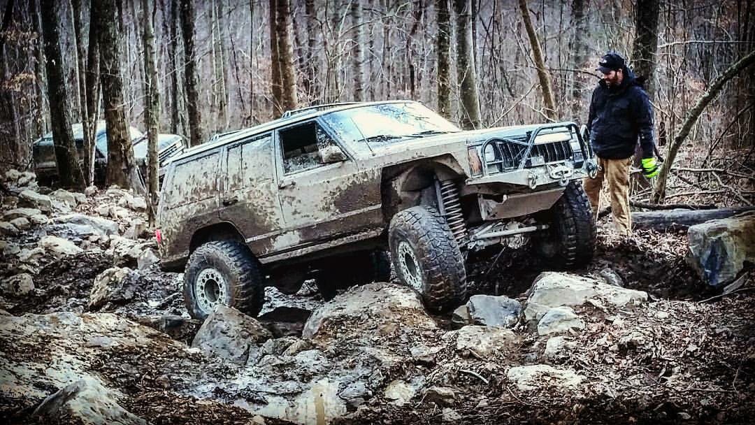

This was my old jeep. Dana 30 front locked with chromoly axles and a 8.8 rear end. On 35s it wheeled all over harlen windrock the flats the shop and ure.
You can wheel the flats on 33s with driving skill.
