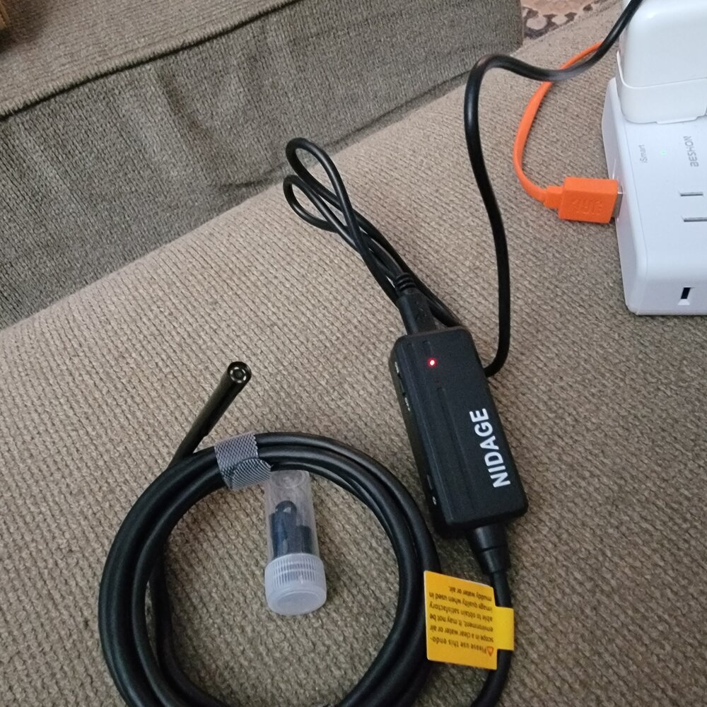

I have a USB-C borescope or a Bosch borescope you're welcome to borrow and I can bring in to the office tomorrow. But I hope you have this solved by now.

I ended up ordering the wireless one the @justjeepin86 had links too.
Hopefully it works. I have not tried dropping it, another good suggestion. I'm waiting until Friday to start defrosting it so I have some time to check it every now and again instead of being gone or sleeping for hours on end, and potentially loosing food

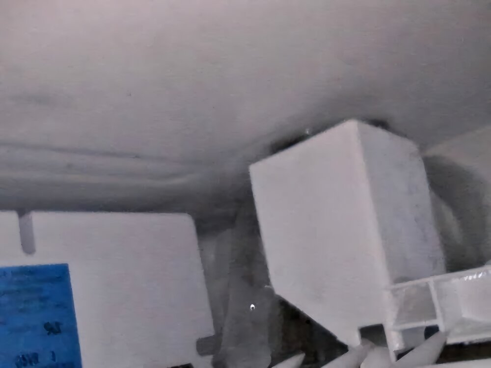

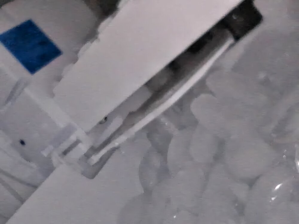

Finally in defrost mode, couldn't get to exactly where I wanted to see but I am conceding it MAY be frozen. But i thought that the arm was going to be jacked up somehow. It may be blocked by the side of the ice tray though.

Worked good. I would have been happier if it was a little more stiff, it kinda droops when unsupported 24"+. I'm happy with the borescope for $24. We will see when I try to use it 18 months from now and it may or may not take a charge.
