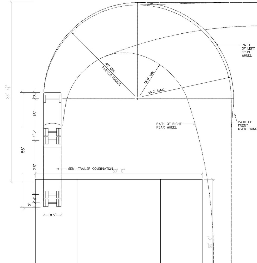

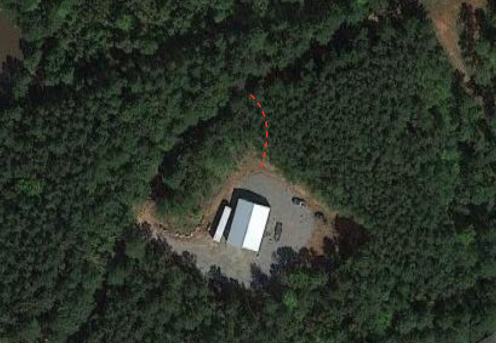

I got kinda the same thing, not enough room on the back side of the shop to straighten out a long
truck/trailer before pulling thru the shop. I am planning to just put in another road section so can loop thru the woods. It will run into a woods road that has a solid base. Less gravel, less parking lot looking and little tree clearing. New road will only be about 125'.
Maybe a longer loop thru the woods with a turnaround would work for you.
