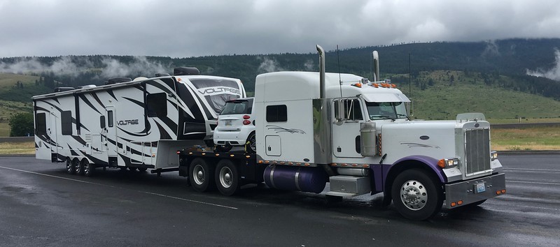

Here is a picture of a similar rig

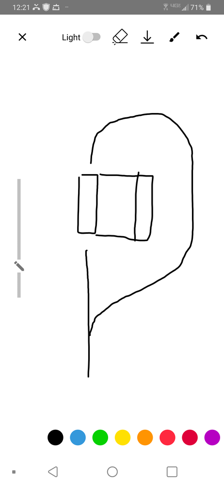

Here is my cad design to show what I had in mind
For whatever reason I was thinking that your parking spot was going to be perpendicular to the driveway.... :dumbass:
Youā€™re going to eat up a lot of space on the back side pulling that in. 90-110% of the length of your rig to pull in straight. Depending on how much wider the lean-to is than the rig.

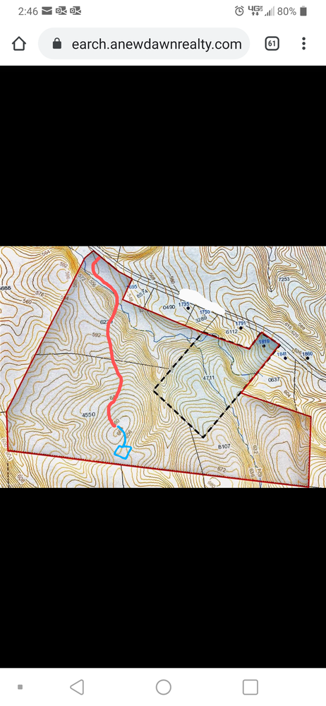

That is definitely an option, I'm currently trying to nail down my exact location for the barn and am trying to figure out roughly how big of a flat area I need to maneuver so I don't build it just to find I have to put 1000 loads of fill in a gulley to turn around.
The red line is a rough representation of my new drive and the house site is at the end of it. Plan is to continue on with the drive to barn nearby barn and possible barn location and drive is in blue
