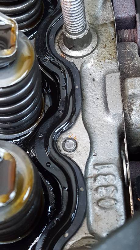

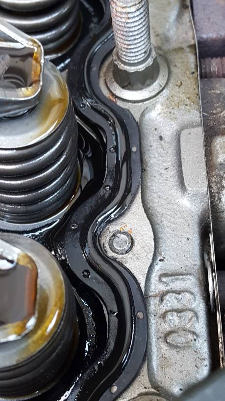

So I was tightening (more like making sure they where firm) valve cover bolts because I had a tiny leak coming from the valve cover. One of the bolts snapped flush with the head. Is there a way to drill it out with out having to tap the hole?

Left hand drill and an easy-out...and lots of grease to catch the filings so they don't end up in your valve springs and ultimately the oil pan.
Be sure and own up and post pics of the broken easy-out. Those things ought to require a license to purchase. :D
Haha...I found out the hard way how hard those bastards are to drill if (when) you break one off...but if you're reeeeeaallll gentle-like...you just might win! meaning you won't break it...lol
I would take a small, flat chisel and try to work it back out.
I usually try a center punch on the edge ccw. Start a divot and then angle it. Usually works. Whatever you do, don't break an easy out. In my experience 9.9/10 times if the bolt sheared in the hole, it's stuck tighter than the easy out will remove. I ended up with a 1/2" hole because I snapped an easy out, then threaded it and installed a bolt, cut off flush and drilled and tapped. What a pain.

Very carefully center punch the bolt. Find a Left Hand drill bit and Carefully drill straight thru the bolt. It may back out while drilling, if it does let it.
The key is the center punch and drilling straight.
Quoted for truth. You may be able to take a fine point chisel/punch and spin the bolt out but I doubt it. @Keith Odom if you can make it wait till the weekend I'll bring a center punch and drill bit plus some left handed bits down with me Saturday.
Always try this first if there is no tension on the threads, because it's so easy. It's finicky and slow, but that's fine if it saves you from more difficult methods.

Lather on some RTV on both sides of the gasket out to the closest bolts and you should be fine. The gasket will be trash, and you’ll have some scraping in your future, but you shouldn’t have a leak.

Have a dremel with a ‘cut off disc’...notch the center of the bolt...back out with a flat blade screwdriver. Otherwise, as mentioned, I usually weld a nut. And that basically translates to, I can’t drill straight...
haha my exact reason for welding a nut! Trying to get a broken bolt punched dead center is pita when I can tack it and ratchet that bitch out!! Lol
