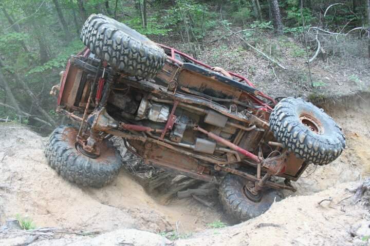

This dude has been rocking his setup for years. 63s in the back and I want to say 56s up front. It'll max out his 30* RTI ramp and he wheels the piss out of it. Lion's Den is the reason he ditched all of his sheet metal.

With the 52s it should push my front axle forward a few inches and with the sliders it keep the pinion from dipping too low unlike with shackles up front. Guess I'll just have to wait and see in august when i get around to chopping and cutting. I do want to rotate the Cs to give it good caster and keep the pinion angle good. Do you by chance have a link to a build thread or some pictures if this guys set up?
There's a good shot of the underside of the rig I was talking about.
