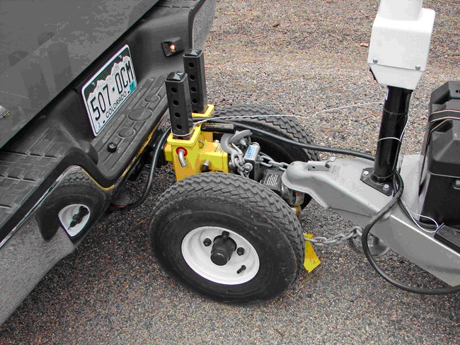

Highway rated swivel wheel
Looking for something like this

Wow. I would not trust that thing for a minute. The way it is designed the wheels are castered for no reason as they do not swivel at all to follow the arc of the vehicle. I can easily see someone rolling the tire right off the bead in a backup maneuver with a loaded trailer.
If the vehicle can't handle the trailer weight then it won't handle the tongue weight. GCWR always applies as the max a vehicle can safely handle.

I'm thinking air helper springs would have been cheaper than that contraption. Looks like a truck/suv bumper
