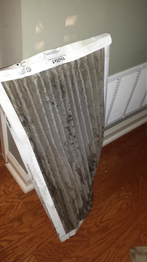

lol beat me to it. Hm that looks like teh typical air filter - its wet, huh?

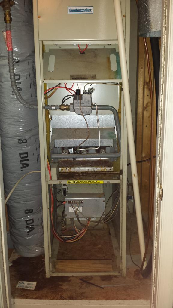

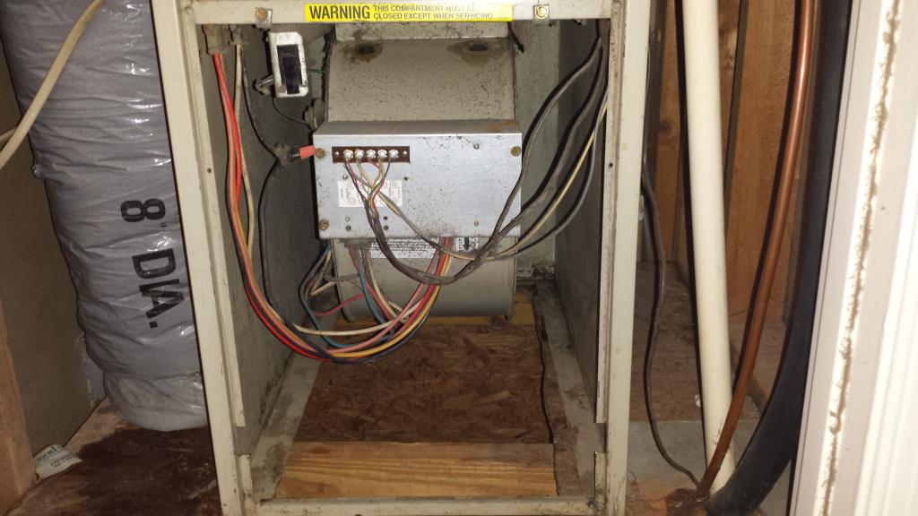

All I'm seeing here is the gas furnace (top) and the "squirrel cage" fan that blows air around the house. Somewhere around there is the space that the condenser coild is sitting in.
My first thought is that the condenser had ice buildup and when it got hot it melted off and got the filter wet.
That dosn't help w/ diagnosing your smell and what actually failed though.

Looks like in the one photo, that the bottom left is wet
I'm guessing that the ac portion is on the top. That looks like a pvc condensate line running down the right hand side. And the filter goes in the bottom? I'd guess plugged condensate, too... But that should be easy to check. Does not look like you have a condensate pump, so the drain would have to be stopped up with lint or something.

From your pic, it looks to me like your heat exchanger (gas pack) sits immediately above your blower and the section above that is your evaporator coil for the AC freon expansion. It should be behind that panel in one of your pictures at the top that says 'comfortmaker' on it. It also will be where the copper lines go into the box of course since those are your freon liquid high side (small) and return low side suction (large) lines. It's likely an A-frame coil and they sit in a rectangular tray that goes around the perimeter of the coil to catch the water as it condenses off the bottom of the coil edges. It's 4-5 inches wide and goes around the whole coil with the center open for air to pass through from the blower. The condensate will drain from that tray into that white PVC line I see in the pic (or at least it better be!). You just have to pull off the cover of that section of the air handler/coil unit and you'll see clearly. Sure seems something is plugged in your condensate drain line and right now those things are pulling off a ton of water. That thing should be dry below that coil condensate tray, definitely no water on the heat exchanger fins/coils or blower area and not at the bottom!!

That filter was pretty nasty - get the impression it's rarely changed? If you let it get all clogged, it puts a lot of extra strain on your fan motor.. .aside from just having crappy flow in the house
Yeah that filter looked like it hadn't been check even before we moved in....with us being new homeowners, I didn't and still don't know all the things to check...but I will be sure to be on top of checking stuff with it now
