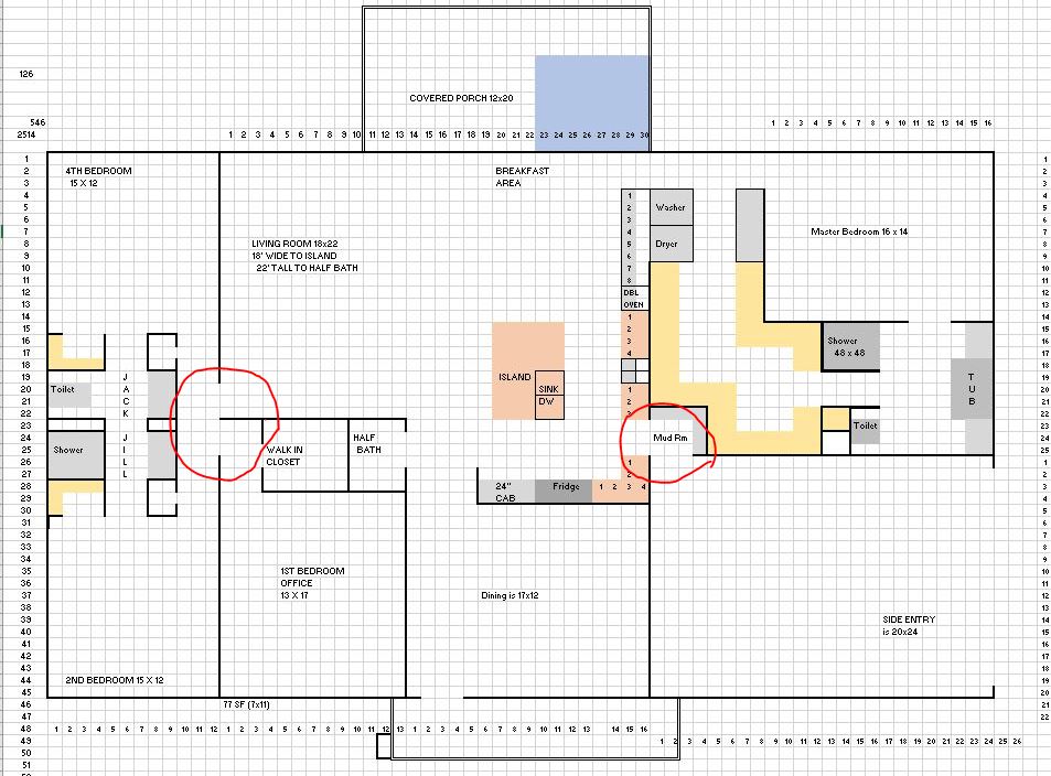

Question #2, I have drawn out (on Excel spreadsheet, ha!) a basic plan, I think it is currently 45x66. Is there a width / truss size that is "standard" aka cheaper that I need to stay within? My lot is forever long so easier to build longer than fatter!? (So 44' or 40' or 48' etc...)
Question #3, is there a huge markup/cost diff to put in a squared out section in trusses so I could have storage up there? Am I compromising something else related to #2?
(Grid is 1 foot square, and also trying to build big enough for wheel chair access in bathrooms, future proofing the home for ourselves and parents, etc)

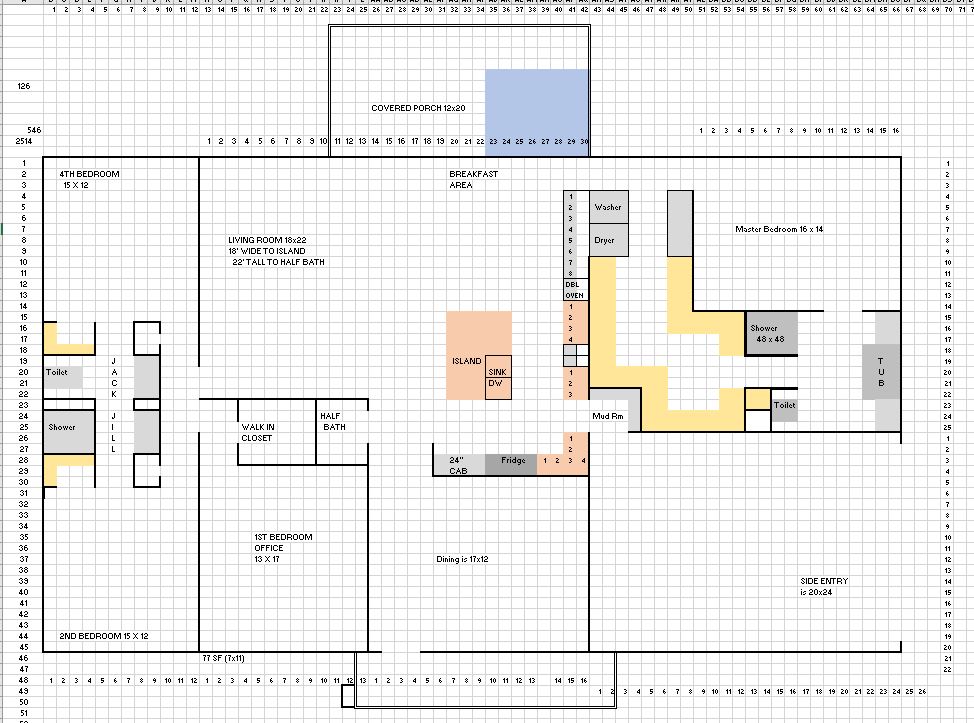

House plan looks livable....but I would try and re-locate that half-bath....nothing like hearing sound effects from uncle bob in the middle of thanksgiving dinner.
48' is the max width you can use 2x4 top and bottom chords on. Given the option, I would run 2x6's on anything over 40' because they can handle more abuse while unloading and at the job site.

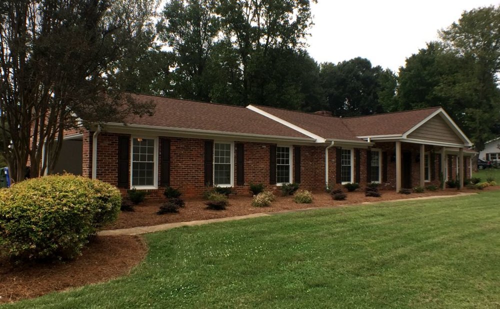

One of the neighborhoods we love in our area is full of 1 story "ranch" homes built in the 60s-70s on .75 to 1 acre lots. That is what I was asking about a few weeks ago and it is still on the radar, but thinking we look for one of those that WE could buy and renovate ourselves. The one we looked at pretty seriously was awesome, but if I am spending that much cash I should wait and build it exactly the way we want instead of compromising just to get what was for sale NOW.
Thanks on input so far, def taking it in, probably flipping that 1/2 bath based on post, good call there!! I realize this might be 'boring' but hoping for stately and will add some "Craftsman" styling to the various posts on the porches, etc.
This is a picture of the home we LOVE, and will go for a similar look at feel. Stepped up roof will likely not happen and wrapping those columns a bit diff, coloring, etc.

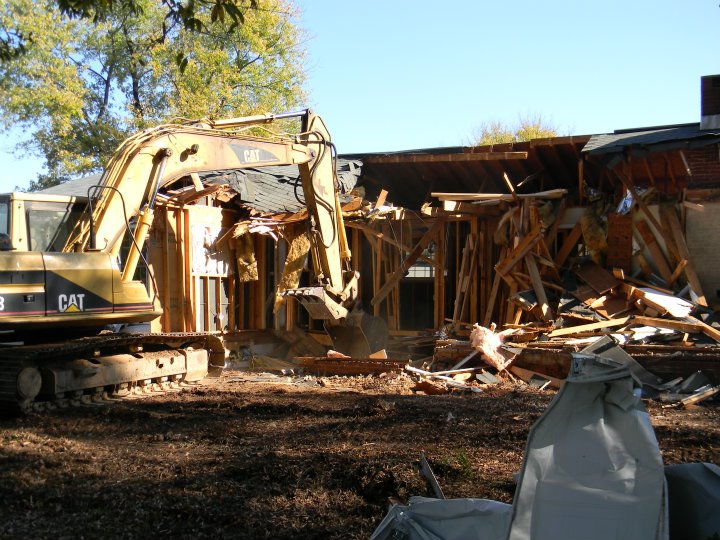

The contractor who won the bid to tear it down kept telling me all day "I lost my ass on this one" due to how difficult it was to tear down. I had never seen a house torn down, so I didn't have any frame of reference. But it took 4 days to tear down and clear off.

2 areas that stick out right away:
You really need to create the mud room entry in lifesize scale. Whether you use boxes, or plywood, or whatever you have. You really need to experience how tight that space will be before you commit to it.
Also, the bedroom swastika entry, it's gonna be HELL getting mattress, table, dresser in the 1st bedroom/office.

I think I would incorporate the laundry room and the mud room into a single room.
I like having master closet access from the bathroom so you don’t have to clothes prep prior to shower and you don’t wake up your wife running around looking for things in the bedroom. I don’t think I would want any other access. Plus more doors equals less hanging space.
You need more counter space in the master bath and bonus for a legit water closet. That way you can poop in peace while she’s getting ready.
The work triangle looks like it might be big in the kitchen if you consider the oven location. I’m not sure that I like the mud room door being right in the middle of your workspace there.
The jack and Jill bath is only accessible from the two bedrooms, so that limits bedroom 1’s access to a full bath. Also, I’ve had a jack and Jill bathroom between two bedrooms and I really disliked it. With that same space, I think you could get in a bath with a more efficient layout that is accessible from the ‘hallway’.

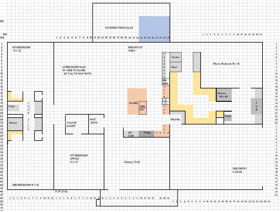

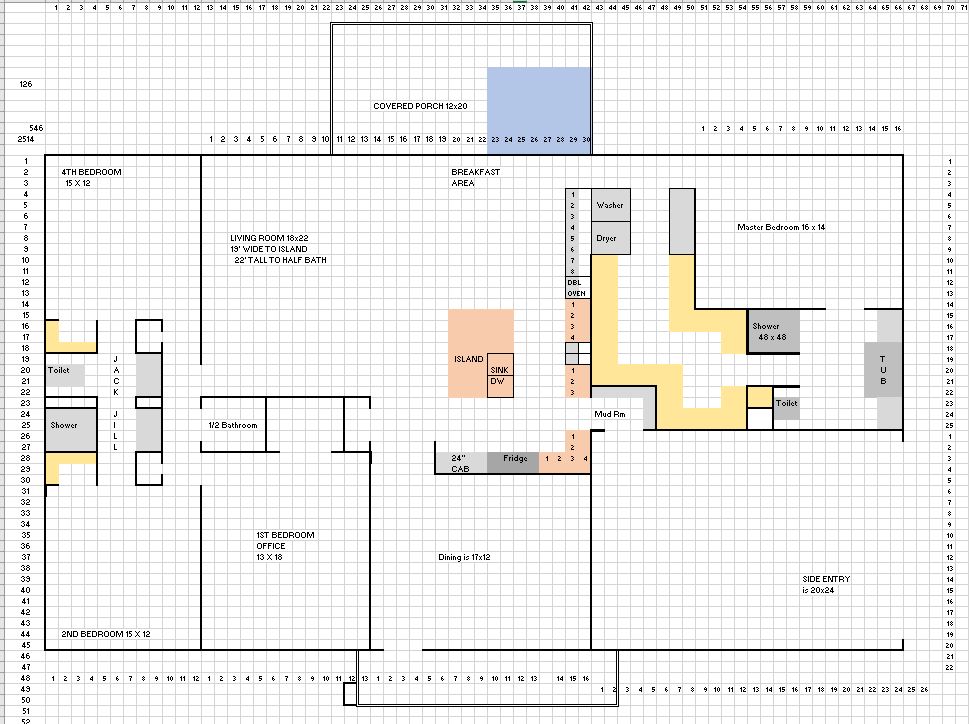

A few follow ups and design changes based on comments from above! I flipped the 1/2 bath to the hallway with the bathrooms. I opened the mudroom out to 4'x5' to give it a bit more room.
Master closet / access to W/Dyer, "weird layout." I actually had created a much more squared out version (with his/her), this was left over from my re-design of a Schumacher home (Charleston A) and my wife actually likes the weird zig zag and some pocket doors to wash room, etc. This will probably change a bit in final design with contractor/architect, etc. Dual vanities at 36" each and a giant tub is her dealio there and mine is "giant" shower, tiled out and I want want of those steam machines built in, that is a "must" for me.
No kids!! The reason for Jack/Jill is this, it was actually suggested by architect student as the purpose of those bedrooms is for our aging parents. Think about this, taking care of mom/dad, having to shower them (wheelchair roll in shower there) and this allows you to wheel them directly back into their bedroom without having to go into the "public" area of the hallway. So really a privacy thing and that made a lot of sense to me and I can see how that would be more useful in elder care situation? That is why there is also 60" of space (sorta) in that bathroom for ADA / able to turn wheel chairs around, etc. Same as my master bath too, I want to live in this house forever. (Built on slab, no steps coming in/out from garage either for same reason / wheelchairs)
1/2 bath has everything guests should need, toilet and sink and if in a party situation we need multiple bathrooms someone can just go through a bedroom. The privacy issue was more important than the occasional need of extra toilet in party situation?
Closets are all subject to change, really just placeholders, "realistic" sizes would be inserted by architect/designer. BTW we met with young lady graduating from FTCC, she charges $17 an hour, about 20-30 hours for full on design, plans, VR walk through, etc. In NC you do not have to be a licensed architect (for good or bad...) and she has the skills to take this and make it a true/real design but that is part of the reason for this thread. Input on things like Trusses, how big a realistic width is, etc.
Same with estimated sizes on the sinks, ranges and all that, I just built in 1' increments, in real life we know that inches are more appropriate in final design.
I walked through one of my bedrooms the other night and I am re-thinking 15x12, the 12' side is too narrow imho, maybe 13-14 or more? I might steal some space from the 5' wide hallway/foyer, would like to shrink the house a bit even, heck if I get down from 2500 to 2250, in theory at $100 a foot that is $25k!?
BTW, the blue on back porch is 8x8 for hottub, leaving room around it but pretty firm we want one and "under roof" so we can enjoy even in rain, etc.
