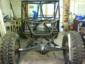

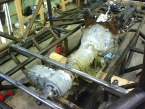

And a drivetrain shot
attachment.php

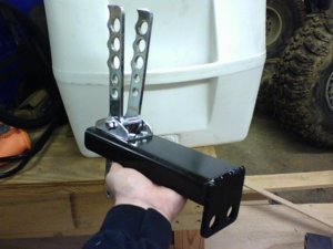

Got my transmission crossmember made, my radiator came in today, and I started assembling my blingin cheap ass shifters.

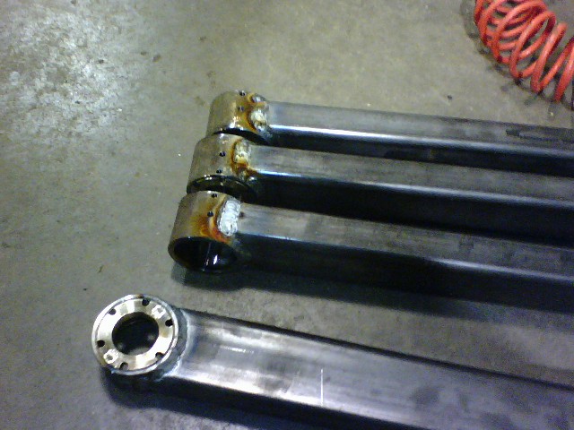

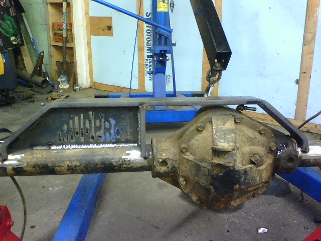

No picture worthy progress, rear 9" truss is almost complete, been welding a little here and a little there so I don't warp it. Joints for upper links have the threaded rod tig'd on ( thanks larry) Hope to get the lower links started this weekend, and finish up the cable shifter stuff. I wish I had time to work through the week to get this thing done!
Got the lower links done, gonna paint them and assemble the joints in the am, and hopefully by the weekend this thing will have the axles under it and sitting on the tires. Still won't go anywhere, but maybe it'll re-motivate me:driver:

Thats cool using the 'cheep' speedway style shifters in that way. Cool setup...
Thanks.
Between the shifters and the cables, I only have about $80 in that stuff. There is also an economy cast shifter that only runs about $20, which would cut the cost to about $50. Between the bracketry and everything, i'll have a guesstimated $150 in them.

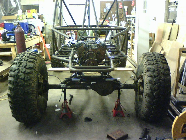

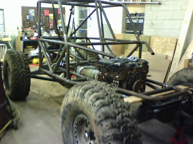

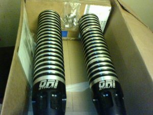

Long time no update, got the front links completed this weekend, the rear uppers are all that's left, then it will get off the ground and i'll get motivated a little more. Still waiting on my struts, ORI is slower than a 96 year old woman in a broke down pinto. As soon as they get here I can finish up the front end, then the tubework for the dash and finish weld everything, then paint and assembly.
Here ya go mud! I finally got this bitch off the ground, and brandon called and said the ori struts should be in in the next day or so. I feel more motivated now!:driver:

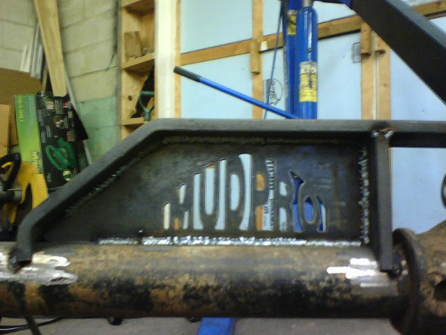

And the rear mudpro truss and bracketry
attachment.php

Thanks, Ordered up some tie rods this morning, so the steering should be finished up this weekend. Some shock hoops and a little more tube work and it will be ready to finish weld.
