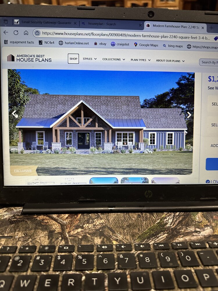

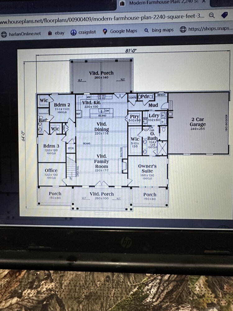

Where can I find house plans close to this without paying around $2000.00 for them the house needs to be 3 bedroom house around 2000 square feet no garage want one that looks close to this would like the back porch to run full length of house my daughter wants to build one.

I not sure they talked to the people who has the blue prints they like the look of the outside of the house but they want the floor plan different than what is shown here they want 1200 for the plans as is but to make the changes to the plans to suit what they want they want 2400 to make the changes.
They want a 3 bedroom with porches across the front and rear and the house to be around 2000 sq. ft.
