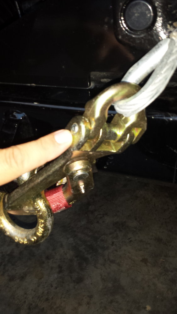

How does this come off?
BigClay
Knower of useless ZJ things
Sep 24, 2008
Winston-Salem
Apparently I am stupid because I can't seem to figure out how to get this hook disconnected from the rope. There has got to be a way to take it off without cutting and splicing the rope. Any ideas?
Is that not a pin between the two C rings?
Yep, I got a few of them. The pin is generally called a roll pin, & it's made of spring steel. It expands inside the 2 halves to keep it in place.But you can tap it in & out easily with something like a punch & hammer.
Make note or take picture, of where all the bushings & things go, even though it's not hard to figure out.
Fire
that is easy.
cigarette lighter
Thanks! I got it out tonight, it is a little too much of a PITA so gonna keep this one for a spare just in case
