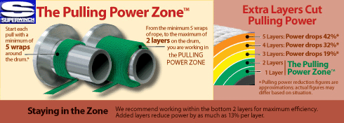

Uploaded with ImageShack.us
was what I was referring to. It COULD be propaganda, for all I know.
Pulling power is a result of leverage. More wraps on the drum equals less leverage. Its the same principle of using a 24" breaker bar instead of an 8" ratchet, only looking at it as if the bolt is driving the socket.
