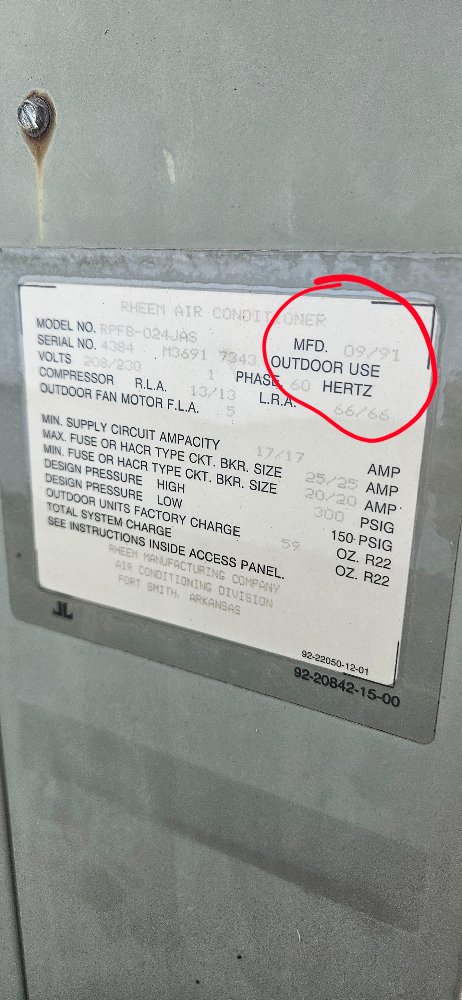

While considering replacement, it has me wondering how long heat pumps really last. My downstairs unit is about 10 years old, but my upstairs unit is 35 years old. Original to the house. It's generally fine, but it isn't keeping up in this 100 degree heat.

That generation of rheem/ruud condensers are known to be tanks. Last forever and way easier to work on than anything else out there. Wish they still made them like that.
