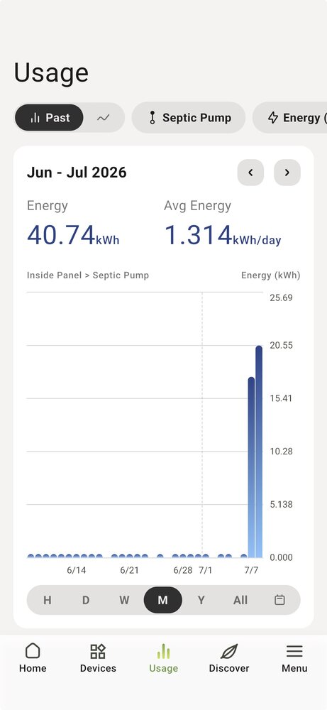

You jinxed me. Haven't even thought about the Emporia in a while. Then, tonight I get an alert from it. Septic pump again. Usually averages 0.15kw per day. The alarm was for Tuesday 17.5kw, and Wednesday 20.5kw. Hopefully it's not the $2k pump again.

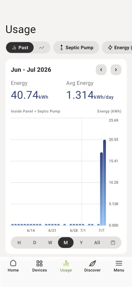

Ten cent zip tie. Float switches were tied to a chunk of PVC. After we replaced the pump, I was going to go in and fix it right rather than the half ass way it was originally setup. Of course, it was never done. Zip tie holding the coiled-up excess wire broke, and tilted the whole thing over. We didn't take care of it right when we did the pump because it was 33 degrees and raining.
