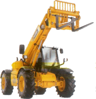

Fork Lift. My FIL has a Ford 555 Back hoe. No Forks but I don't think it has the ass to lift it.

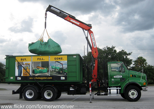

You need to get a Bagster (dumpster bag) and then bribe the guy when the boom truck comes to pick it up. Bagsters can hold 3300, so the truck is plenty capable of lifting the playhouse. Throw some slings under it and have it waiting......
I don't really have access to it. Would be asking quite a bit. Was hoping to avoid it. I'm not a huge fan of borrowing or asking favors.
