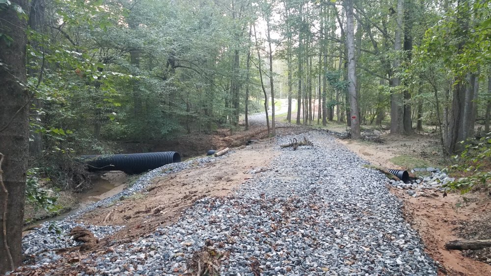

No trees down, but I got a little bit of water.
Before:

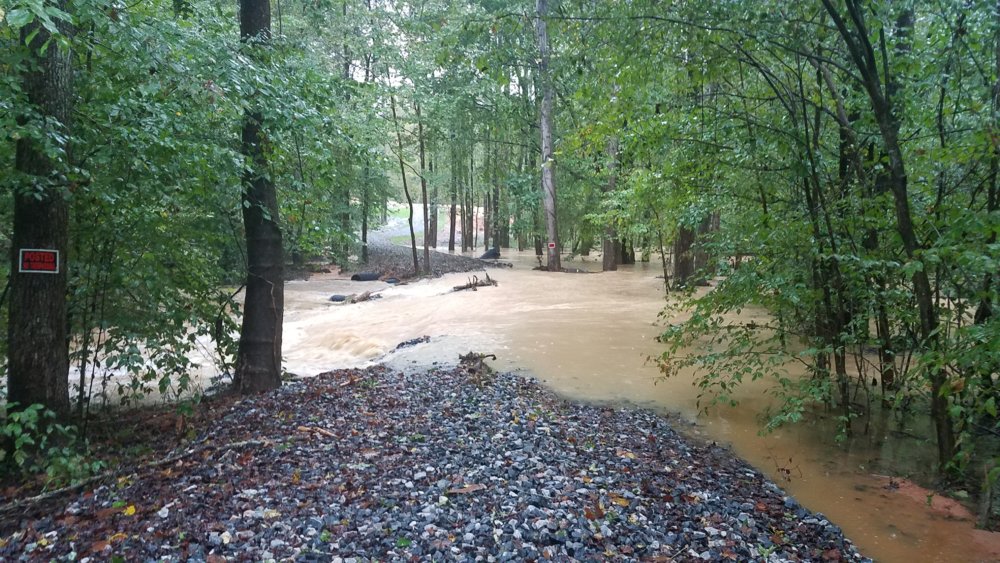

During:
(note: Dead center of pic, the mouth of the 30" pipe sticking straight up out of the water)

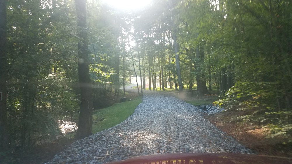

After:
(note: 30" pipe sections to the left, and look dead center of the pic to see where the water ripped that pipe out like a water jet cut it clean across the road)

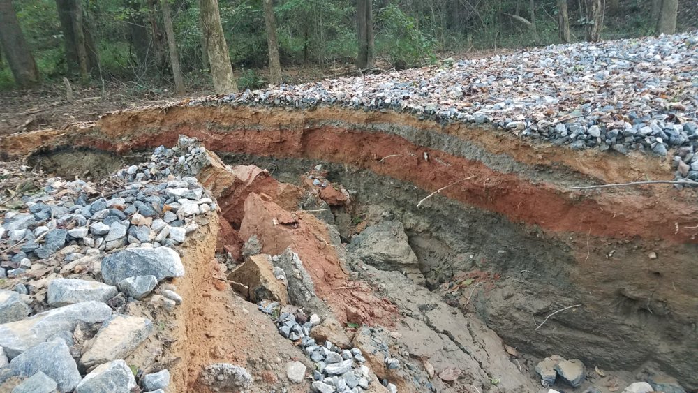

Close-up of where the pipe was

Looks like a need a ford instead. That float pipe didn't stand a chance. What did Florence do in that area?

Flo did nothing. The 30" was a secondary. the primary is a 48" with concrete on the face plus rip/rap. 30" had riprap but no concrete. I think something got under the 30 and the force of the water ripped it out like Predator ripping out a spine.
I will grade 40-50 before the creek lower to allow a natural overflow ford for the NEXT 100yr flood :shaking:

Was gonna say, once that pipe floated or got pushed up, it no longer flowed any water. But might not have made much difference. We all saw State roads, with Deeper buried Steel corrugated pipes, Pushed right out! Probably as they clogged with debris. Seems if you get that type flood again, a Bridge might hold. If the Footers do!
