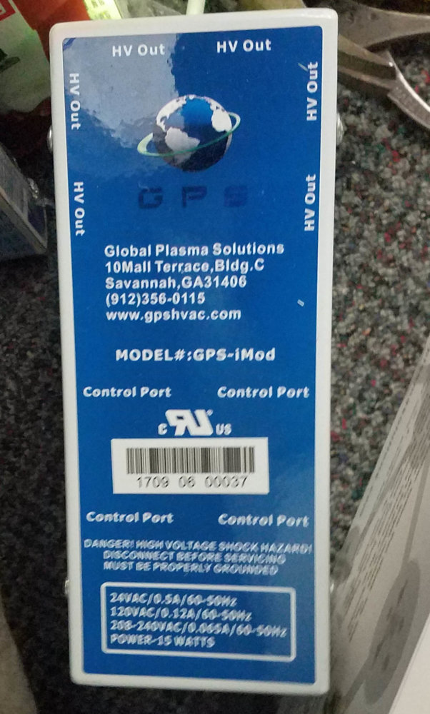

We have 2 different 4 ton units in our office. One to control the front half, one to control the back. We've had IAQ issues over the years and wanted to change that. We had several vendors interested in "helping us". Listening to all their different pitches, and seeing their product, we asked Hoffman to bring one of their GPS units to test. They came and installed one of these in the front unit so we could have a side by side comparison.
The front offices smell great! No issues, and the filters are noticeably cleaner
Why Use GPS? – Global Plasma Solutions

Trane has a more cost effective solution, and for residential applications. If I remember correctly I was going to pay $300 for a 2.5 ton, and $250 for the 1.5 ton for my home. I never pursued it though.
But as you can see from Scott's post, going the manual route (i.e. filters, cleanings etc) ANY solution will involve materials/labor of SOME kind. I was skeptical of the ION pushing sales pitch before, but I'm a believer now. It truly is a "set it and forget it" solution. I'm allergic to basically everything but poison ivy/oak and use to sneeze constantly here in the office. I may sneeze once a day now.
