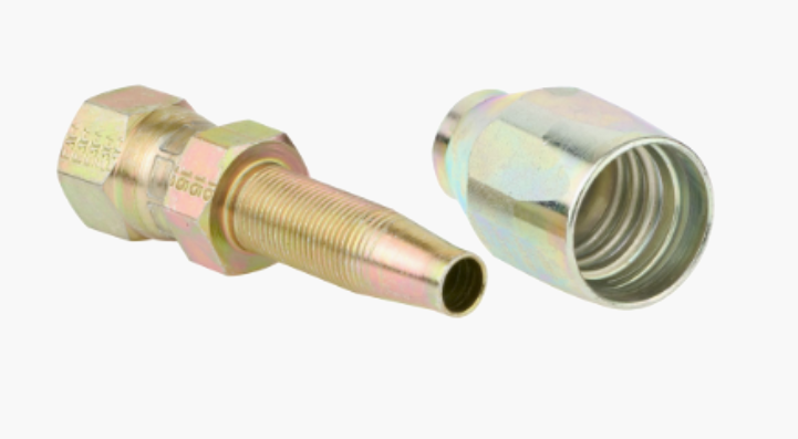

I guess I am not sure why you would not use field fittings? These are not expensive and require no special tools. In the picture below you take the larger outer collar, screw it over the outside of the hose, then using some assembly lube screw in the inner fitting through the collar and it wedges/seals the hose to the fitting. You can get them in a variety of couplings and bends so you just purchase the fittings and some bulk hose to get started. You can order fittings online and get hose locally or order that online as well. Then your hoses can be precision fit "on vehicle" as you build it without having to measure and have a place build them.
I have blown 2 of them on hard steering hits.
To me, the don't hold pressure spikes like the crimped ones do.
This is why I’m not going with field fittings. They’re great for a trail fix but I’d prefer a properly crimped fitting since I’m currently in the shop.
