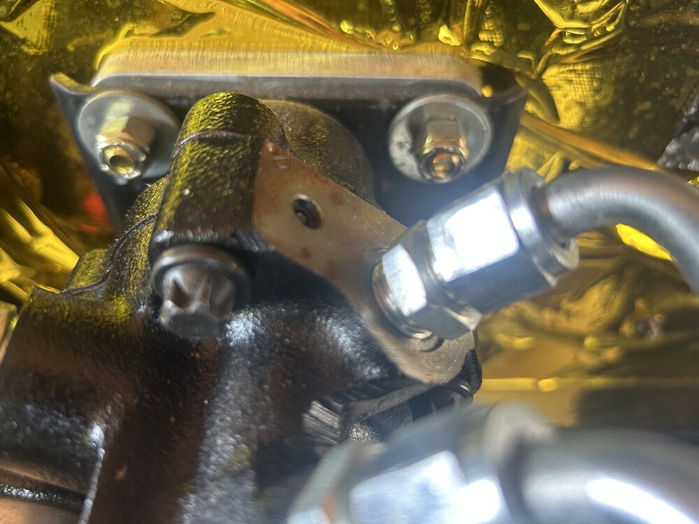

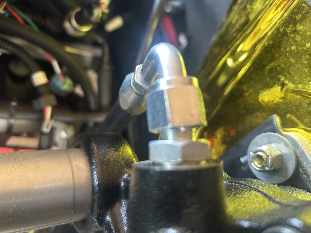

Both pieces came from a cpp brand kit, when i hook up the adapter to an6 fitting it is a good connection, the field serviceable end is crooked though. Not stripped, but appears to be loose threads on the field serviceable end. Ended up buying hoses with swivel one end 90 other end and 90 degree fittings. Problem solved.
Would still trust a brand like fragola, Brennan industries, Parker etc but the cheap ebay ones are a gamble
