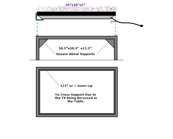

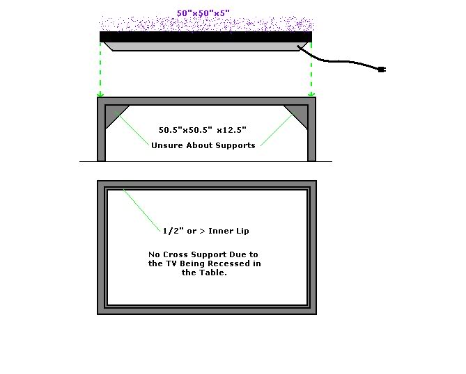

The Plan....
Ok, this is the best I could do with windows paint since I am on a work computer and dont have any programs on here. But you should get the idea. I want to be able to remove the TV from the table just like you would a peice of glass so I will have easier access for the blacklights to change bulbs out and whatnot.
The plan is to build the table a little bigger than the TV and have a lip for the TV to sit on. I want to use 1" or 1.5" square piping and am not sure about how I want to support the legs. I Think this will turn out pretty well if I can just find the metal and a welder (which I might have a buddy with a couple). So anyone know where to get some free or really really cheap peices of metal? The measurements arent exact on this daigram.

Ok, here's what I was thinking, and still suggest, for that frame.
What is the distance shown in red on the right? I'm guessing maybe 3"? 4"?
Get yourself some .250 angle steel, big enough to provide a ledge for the bottom edge to sit on, and cradle the sides as well, illustrated by deep greenish blue on left. Do this around all four sides, and it will provide axactly what you were asking about above. Where they meet at the corners, just a 45" so it meets up. Look at the back of a pictureframe, same idea.
then you can weld legs (1.5" .120 tube stock) either to the sides of thsi frame, or teh underside of the corners so it matches the profile.

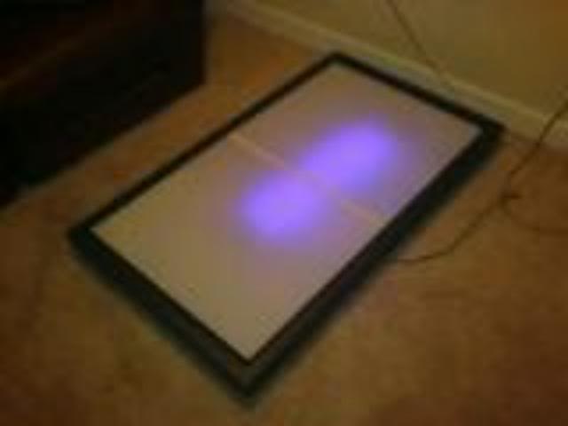

The TV....
Ok so here is what I got accomplished so far....
I do not like the peice of 2x4 in the center, so I think I am going to go with glass instead of plexi, it will be better all around and wont look cheap. As for the blacklight, it didnt pickup on the white backdrop I have on it now so I will probably do clear glass and put the circuit boards back on the inside, that or something else to showcase that picks up blacklights. I also think i will need another 24" blacklight. As for the 1/2" of wood that is showing, I need that extra inch to have the back half clear the blacklight, so I will paint it black. Here's the pics so far.
Wow.. those pictures turned out like garbage.. I think they lost a megapixel or two on the transfer. I will get better clarity later, but you get the idea.
