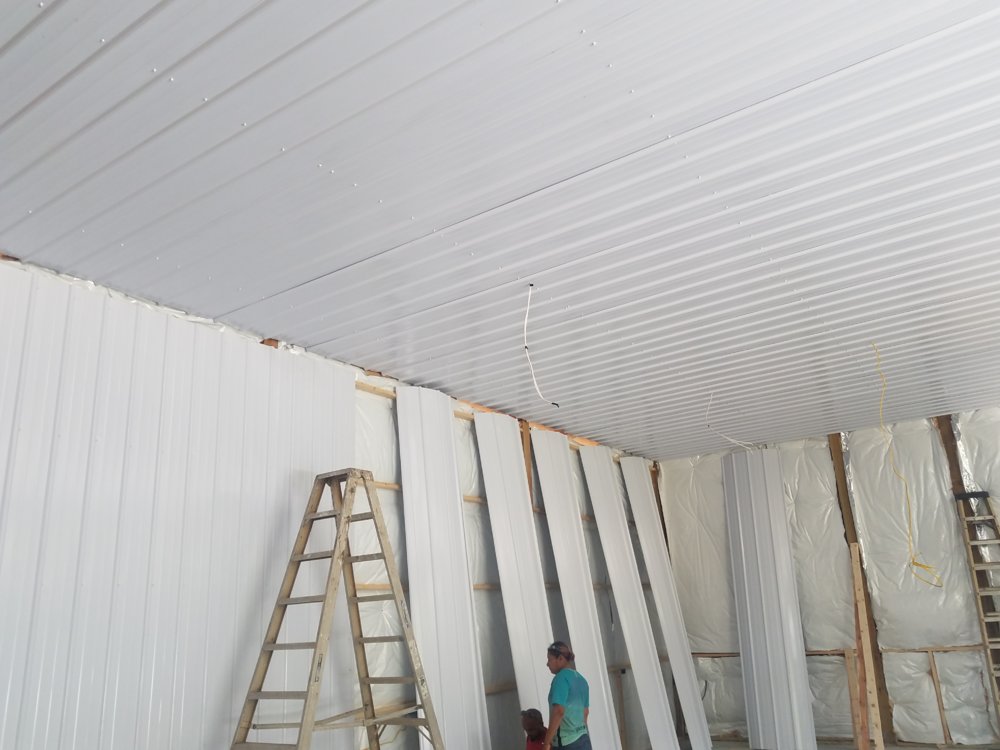

My ceiling is a 30ft continuous piece 48" wide sections

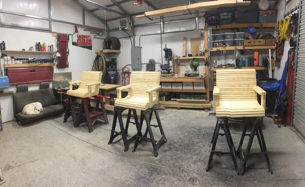

Nothing to add other than 4 years ago I thought a 30x40 would be plenty of shop, today I need about twice as wide and 3 times as long (that's what she said). Oh, and outlets outlets outlets, I'm not sure it's possible to have enough outlets.
