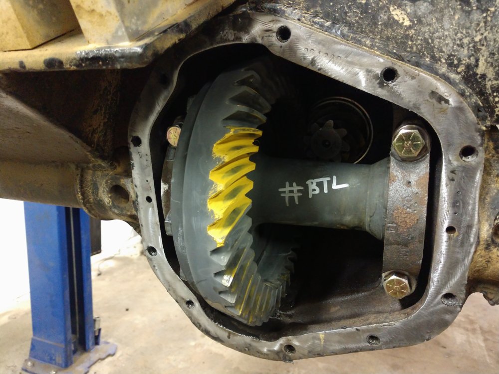

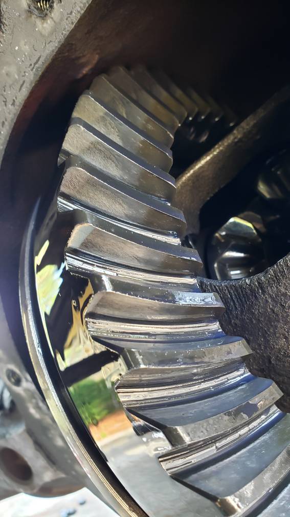

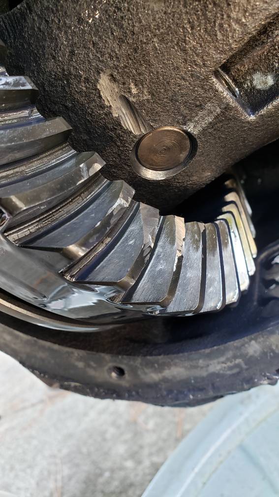

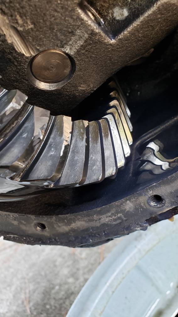

I'll refrain from staying who did this publicly for now. (Edit: Get Ugly Offroad) I took my jeep to a local offroad shop for a gear swap. 4.88 Yukon front and rear. I got it back with some bad noises. I took it back the next week. They kept it for 4 days. Fixed nothing. Want to guess what it sounds like by looking at the pictures? I opened it up because he said the noise was from the outer axle bearings. So before I opened it up to check, I ordered Koyo bearings and seals. I opened it up today. Took these pictures. Swapped the bearings. Of course it still makes the same exact noise. Oh, and there was no thread locker on the pin retaining bolt. Of course there is now.
Enjoy the pictures. Im completely open to discussion. Please fire away! Lol. I need ammo for when I go back again this week.

Wow. Not only is the pattern way out of spec, but what's with the clearanced teeth? Incompetent? That's putting it mildly.

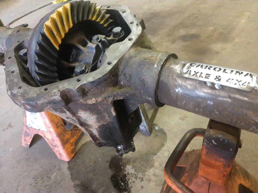

Clearanced teeth are for the cross pin, this is what it should look like if done properly. On an 8.25 once you get in the lower gear ratios the ring gear gets thicker.

To the OP you need a new gear set, that Freddy Kruger cross pin clearance is more than likely where you noise is coming from, that and the pattern look poor too. Your more than likely screwed either way you look at this. For one you touched it before taking it back, and for two even if you took it back and agreed to fix it your just getting the same poor gear install as before. I'd shoot for a refund and take to a shop that reputable.
Not to add fire to the situation but that gear cut in the root doesn't look like a high(er) quality set does, I'd double check that along with the setup in the front.

"Not to add fire to the situation but that gear cut in the root doesn't look like a high(er) quality set does, I'd double check that along with the setup in the front."
That's not the factory cut. Looks to be the depth of the gear engagement. The fanned profile of wear is also working through the hardened face already.
Any further use and your risking a much larger failure. Of loaded or towing your asking for a lot of heat.
The grinding was a horrible clearance job for the pin......gouging the carrier isn't the best either. Speaks of the over all lack of professional quality.
