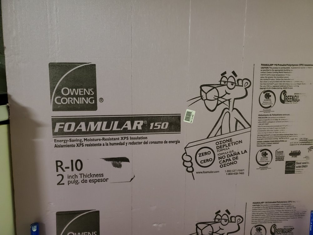

So what's the better alternative? I'm considering a 3 bay barn style carport with one side enclosed. I was thinking something like this pink foam board between the posts. Mine wouldn't need to be sealed up completely tight.

why not go with the 2" thick styrafoam stuff...cheap, easy to put up and it does the job pretty well for the lower cost, and looks pretty neat. Then you can put paneling or even sheetrock over it. IF you get anything sprayed I would do the ceiling and corners where you loose most of your heat and a lot of your condensation will come through the roof anyways.
