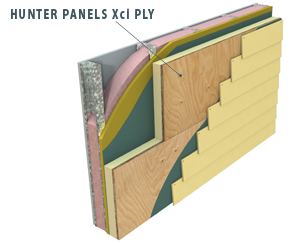

The company i work for just picked up a new product line (XCI Ply) that is poly iso laminated to sheathing (of your choice). Pretty much any thickness you want and rougly $2.5 a sqft. You can even get sheathing on both sides if need be.
Again though, windows and jamb details might become an issue.

@farmboy, that's an interesting product. We were having issues with the CI requirements in wood frame - partly due to how the windows install (face nails in the flange) and NFPA 285 issues with the exposed insulation in the cavity becoming a hazard. Looks like that addresses both.

@shawn it seems to be the answers for alot of problems...but Vinyle windows are still lagging behind. NFPA 285 is turning alot of worlds upside down. We sell a ton of rain screen products and are dealing with it everywhere.
