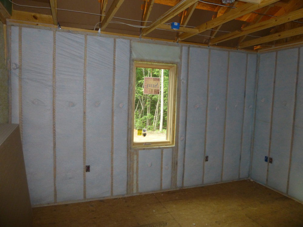

Here's a picture of our BIBS installation, just for reference.
The only concern, I have with the Bibs/lf fiberglass insulation, and its a minor one to be sure, is if you ever have to or need to retro anything in the wall cavity you are going to wreak havoc on it.
