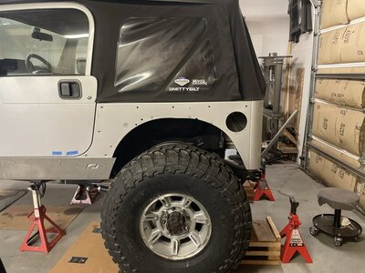

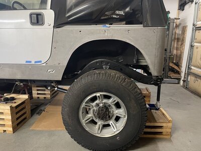

I’m building a TJ on 60s am I’m at the point I probably need to get so real tires so I can cycle it and dial in shock mounts etc. Pic is on 2” springs, no fuel, no back seat and a 315 that measures 33”.
Intercos 17” rim options are limited. The plan is something around a 37. What do y’all recommend?
I’m afraid the 36x12.5 SX is 34” when mounted and the 39x15 TSL seems huge for a mild stretch TJ. Are the SX2 rock hard? 37x14 Iroks shaped like a beach ball?

I had some 38x12.50-16.5 TSL SXs on recentered 8 bolt hmmwv wheels back in the day and they measured 36" tall. So a 39" might be a 37", depending on rim width. 8 bolts are 8.25" wide....a lot of their tires measure pretty short compared to the sidewall listing.

I run a 42 SX2 on my beater xj. I've had them for a long time. I would not say they are hard but they have thick sidewalls and are very durable. They are not a sticky by any means but they are a bias ply like a lot of off road specific tires. My on;y issue is that my 42 is heavy with the H1 rims. The ole I6 can't turn them over like I want to some times. Interco has a lot of 17 options. 37's does limit it some but there are options. I assume non street tire so no radial.

37" Treps don't measure out to a 37, I think the ones I had (used, stickies) were not much bigger than a 35. And I ran them on a Toyota axle buggy.
My new buggy has 39.5" sticky Iroks and it's also on Toyota axles.

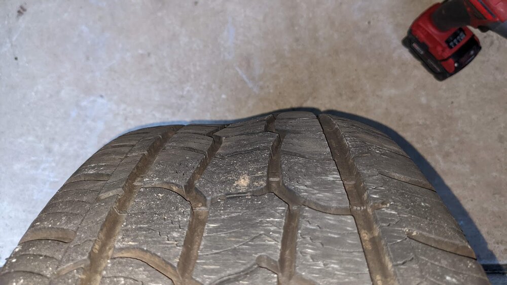

They had a recall earlier this year, I believe, possibly last year. It was for belt separation. We're those part of the recalled lot? My uncle had two in his set that were, but they did him a solid and replaced all four for free.
I've probably got in the neighborhood of 200,000 miles on 5 different sets of Cooper made tires between 4 different trucks. Hell, the ones on my HD right now are blems. I haven't had any tire related problems out of any of those miles. Yet. Hopefully I can continue that.
I totally agree though. Those two tires are certainly enough to totally dismiss the fourth largest tire manufacturer on the planet :D I had to...couldn't resist!
Real talk, that does suck though. It surely can't have anything to do with all of the wonderfully kept roads we have around NC these days.
Which tire model? What size? How old?

If you are set on interco, 38.5” sx. My 42” sx2’s were softer than std sx’s when new but after 5yrs were harder according to a durometer. Had to run them at 4-6psi to get them to work Offroad, which made them have same radius as my 39” reds at 10psi.

the 39.5x15-17 TSLs on a 17x9s measure about 39 1/2 new with 28psi in them. On the K5 they are just over 38
I ended up with a set of Toyo 40s I snagged off of Market Place during a work trip to Greenville. I've got some more trimming to do, but I think it'll work out. 23.5" bottom of the frame with no real weight in it.
