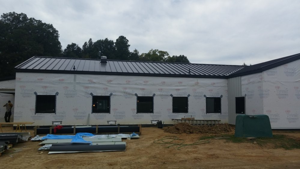

Metal isn't a lot more expensive than shingles and I prefer it. I do a lot of commercial standing seam roofs these days but used to do a good bit of master rib which is what most put on houses.
Here is pic of a standing seam roof I just finished couple weeks ago on the rowan county animal shelter. Its 24ga standing seam. Thats what I'll be putting on the next house I build for the wife and I.

That roof looks amazing. I tend to lean toward things that look clean and modern, so that checks all the boxes. I will need a roof for the big garage being built next to the house this spring/summer, so may consider doing metal on that and the house.
