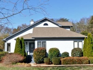

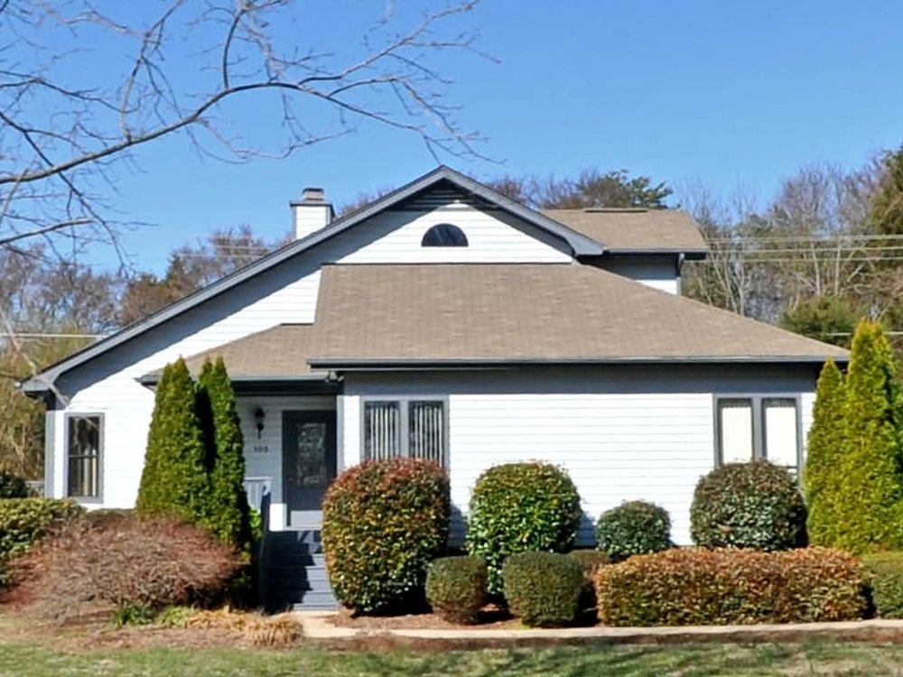

I believe it's a 12/6 pitch. I'm planning on putting a digital level on it today or tomorrow to verify, I just need to grab a ladder on the back deck.
Old picture from 2012 I think, before we owned it. I've got rid of every bush and crappy arborvitae in that picture except for the awesome Japanese maple. The footprint is only about 1400 sqft. It's actually a simple roof, the porch roof and the upstairs bathroom bumpout at the upper right are the only bits that aren't part of the same continuous area.
That half round window haunts my dreams. It's getting replaced with something that isn't shitty looking.
