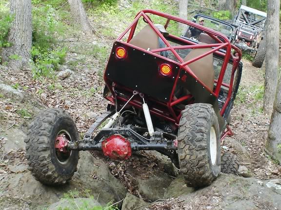

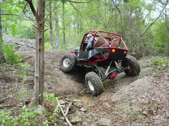

If I may give you a little a little advise on the 1/4 elips, your shackle setup from the pics looks a little close to the link mount. those shackles will move foward and backward alot! if it hits that mount something will break. on the 727 d300 with my 3oo clocked flat the drive shaft hit the front corner on the trans pan! you have to run a small driveshaft which sucks. thanks for the kick in the balls (METRO). anywoo heres a couple of pics that you can see the shackle movement, a slightly different setup but same concept.
nice jeep... (who are you in metrowars?)... and my mounts would have to be almost flat.. well maybe 20 degrees.. before they hit... but ya.. i am going to watch it.. i had to move the link mounts to where they are due to the frame mounting i wanted.. so i had to compromise some... i should be getting the disk brake set up on this coming weekend.. which should be interesting... lol..
how do you like your set up?
I have built 2 1/4 elip suspensions both worked very well. I will def do it again on my next build. whenever that happens. the real challenge is shock mounting, the way they are mounted in the pics was a compremise but worked out very well,allowing for alot of flex without bottoming or topping out the shocks.
