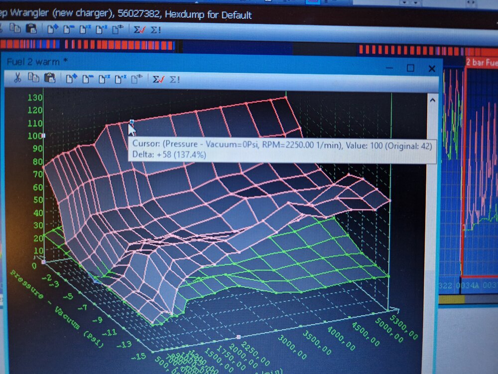

I continued some more with the supercharger, got an m62 instead of the m45, with a 60mm pulley. It's doing 0.5 bar boost but I ran out of injector room. Also between 2000 and 2750rpm it runs real lean as it it is still in closed loop but can't manage to compensate as it's at 0.4 bar boost.

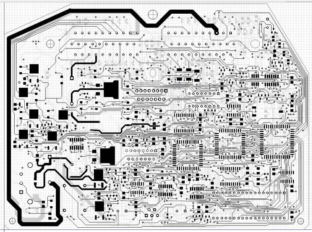

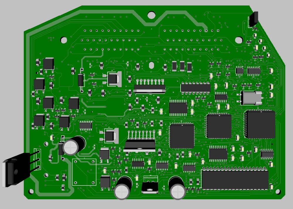

Thanks. It's not perfect, probably never will be, but given the original will likely never see the light of day this might be useful to someone at some point. It's about as accurate as I can get it without spending loads more time on it and poking around inside of a working one. I actually rebuild the PCB from the schematic, in the same software that I use to make the schematic, to make sure the traces match the original board and that things are connected correctly.
View attachment 404862 View attachment 404863
If anyone notices anything wrong or has any info on anything in there, like U9 in the power supply, let me know. I spent too much time as it is looking thru as many old Motorola datasheets for SMPS chips that I could find and nothing came close.

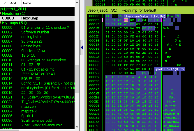

Here is some more info. 00013 is to deteremine which gearbox type and there is thepcm software numbers (some have two different ones)
View attachment 445240 Here is some more info. 00013 is to deteremine which gearbox type and there is thepcm software numbers (some have two different ones)

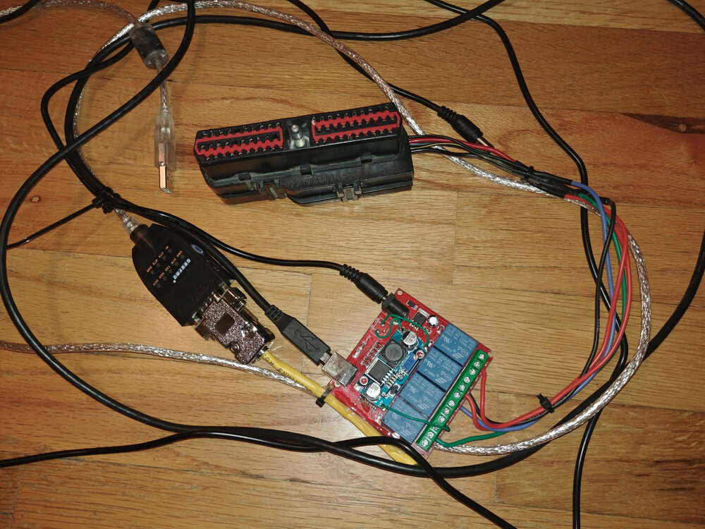

I built a programming interface out of a relay board and a boost converter and have started working on
erasing and writing the EPROM without de-soldering the chip. I can get the chip ID and erase the ST chips
but was having problems erasing the Toshiba chips. I have a DOS era EPROM programmer that can
program the Toshiba chips, so I got a logic analyzer and wired it up, but I still had issues with the
code. Sometime after I made the post I figured out the problem, I just needed to add a little delay to the
code to allow the 20 volts to be applied to pin 45 before interacting with the EPROM, I deleted the post
because it became irrelevant. I'm pretty confident I can program the ST EPROM's and likely the Toshiba
chips as well. We'll see, how using relays to switch between data and programming voltage, will work out.

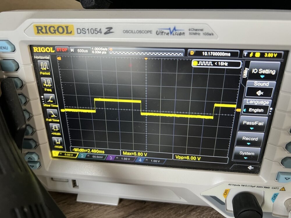

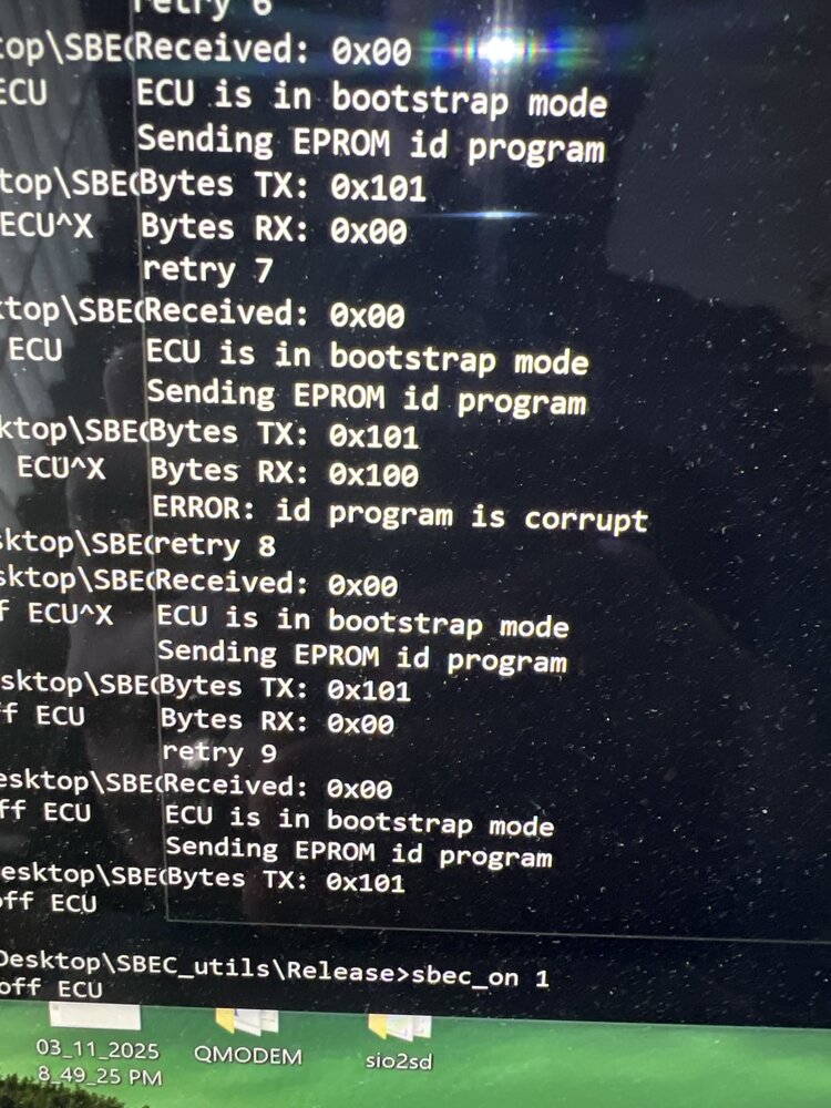

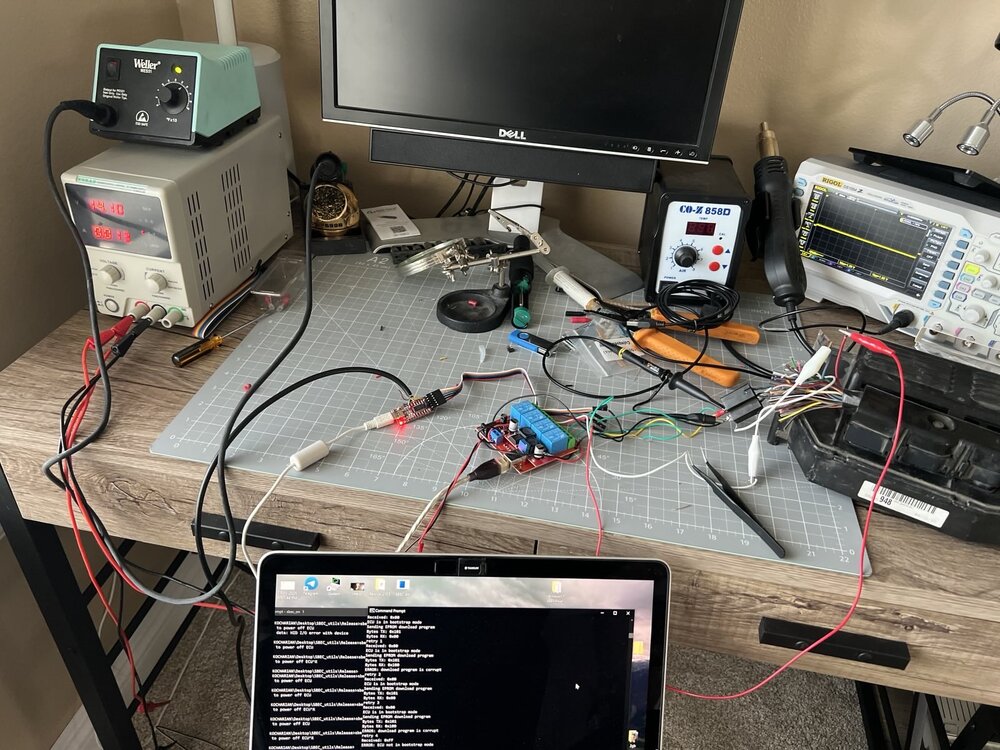

Adam, I got your flashing interface built with the relay board/boost buck. I got it to bootstrap the SBEC just fine and in boostrap mode, I can use the CDT tool (that I poosted in the zip file above) to communicate with the SBEC just fine while running SBEC_ON but when I got to use your utility, it seems like its not reading back the same bytes it's sending and erroring out.
Running any of your utilities will bootstrap, begin to upload the code but then error out.
I scoped the TX line and it looks fine, the levels look nice and square. I'm out of ideas on why your programs wont work.
I know you haven't been on here in a while but hoping you'll see this one day and help out. Wish I had your email address, no other way to get hold of you!
The fact that you received something from the ECU is pretty encouraging.

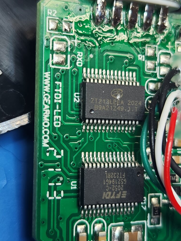

I took the usb to serial adapter I am using apart, I has a second line driver chip, the data sheet claims that it boosts the line voltage to 10v and provides short circuit, over voltage protection and ESD protection.
Also switching the serial port with a relay is very noisy the capacitor is an attempt to filter the noise a bit and you may have to experiment with the value.
this is the usb to serial adapter I used
you can also find a board on aliexpress that appears to be very similar

the ECU is using CRC8 to checksum the EPROM, CRC 8 just adds all the bytes together to get an 8 bit sum then compares it to byte 5 through a subtraction operation and if the calculated sum and byte 5 are equal the checksum function returns if the checksum fails then the ECU stores error code 35, if you change anything in the EPROM the checksum should be recalculated so the checksum function succeeds and you don't always have and error code stored. I'm choosing to keep the software number the same and storing a correction byte at byte 12 (0x0C).
Well, wowzer over on turbomopar has been working on his version of the 781 cal, but I got the fuel and spark tables mapped out in my cal. Load it in MPTune and you can look it over. Another PCM would be easy enough to make a cal for since this one is about finished (at least as far as compiling back to the original, tune is dependent on the vehicle)
