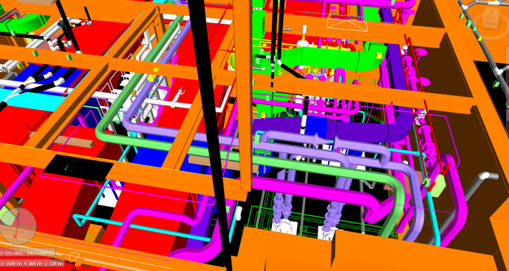

I've got a much more clear-cut description for an engineering job listing:
Here, make all this shit fit in a virtual environment...THEN, coordinate it's EXACT location with installers (who generally work for beer money)
We will ultimately hold you financially responsible for ANY deviation from the virtual design, should it NOT work out in the field.

Also, the lighting in that model is way too good, and it doesn't show all of the other constraints such as the pre-existing structure you have to work around :D

I hope that design isn't final! ;) Lots of interferences! Looks like some of the projects I get thrown on to fix once the piping is going in and everything interferes with each other.

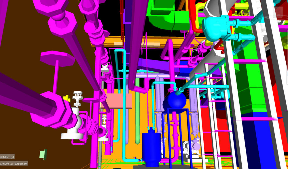

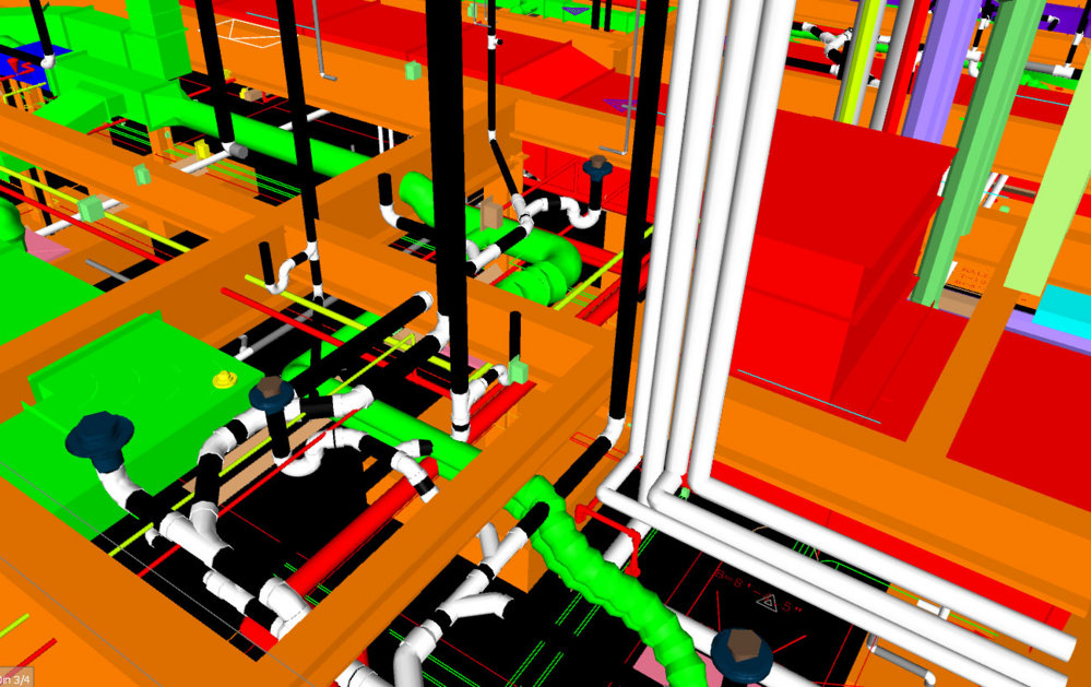

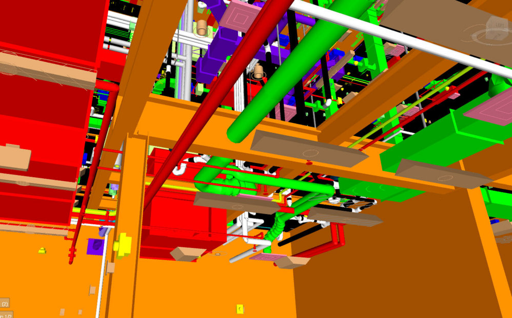

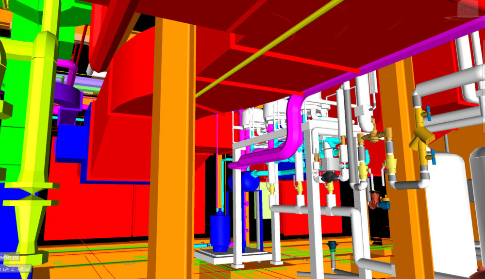

That's not even the worst part.....here's the mechanical room (looking overhead thru the 1st floor slab) and this is without pipe insulation!

That piping design confuses me too. Looks like the pumps will do nothing but recirculate. Don't see any control valves anywhere...
I'm surprised there is that much interference. Pipe supports and steel isn't even in there yet. That will add to it even more! Lol
Sure glad that's not mine but it really does looks like a fun project
That was just the CWS pumps from the chiller plant. SOME support steel has been placed in the model....(steam on the left in this shot) but it's a cluster......
The REAL fun is we're doing the BIM modeling only weeks before the actual installation (failure on the GC's part)
The actual design engineer of record for the project submitted the biggest JOKE of an actual Revit Model that I've seen. I truly expected more from a "Charlotte firm" of this caliber. This has been a nightmare to "fix". And yes...this is the FIX. If you saw what was "designed" originally, well...lets just say the client got royally screwed for what they paid for.
Those traps, strainers, and valves look like fun to service and operate! Lol
Are those heat exchangers supported by the multiple posts tucked up high in the ceiling???
Yes (SMDH)
That's in addition to the hot water generators and their serviceability (between 2 giant ducts 5'-7" in the air)
Man, that would be a really fun project! Not necessarily laid out the best but would be fun figuring out how to make it work right when installing!
That's where I am now. Dimensioning this mell-of-a-hess so that the subs can install it perfectly.....all the while the installers are arguing with the walls guy and the structural people because they forgot things....like, depressing the slab for the bathroom tile, and putting in the structural walls in the wrong location. This, on a job where fraction of inches means the WORLD on a core drill for a combination waste and vent sewer riser that CANNOT offset (going up 4 floors)
