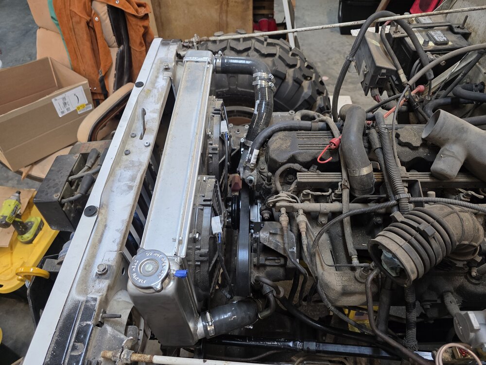

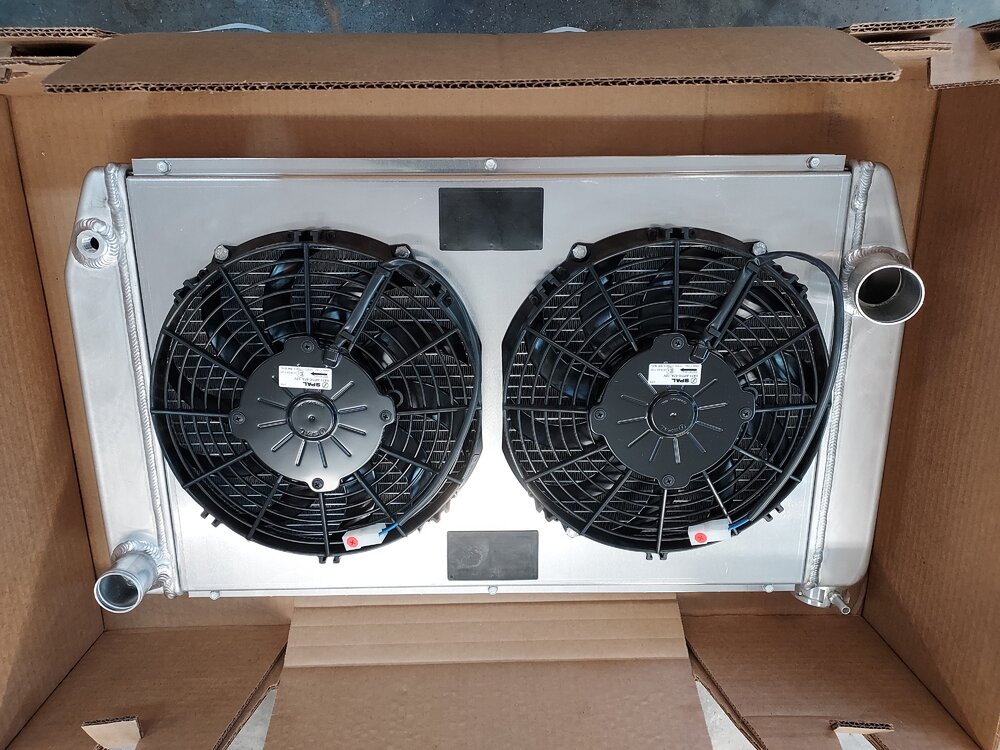

I bought this Griffin radiator with fans package 1-1.5 years ago. Finally pulled it out of the box for a test fitting. Embarrassing :shaking:

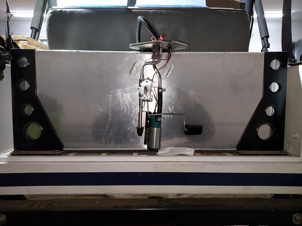

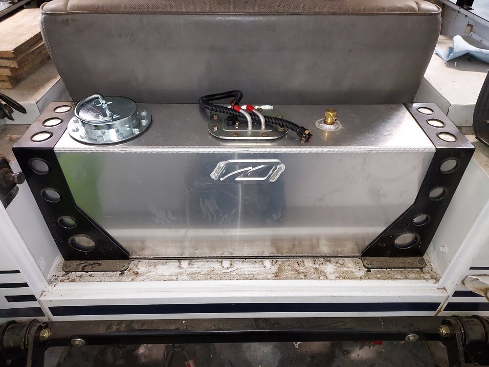

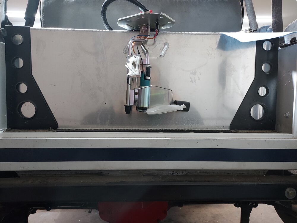

I went to install the fuel pump/sending unit in the Motobilt fuel cell, and noticed the pick up was about 2-2.25" from the bottom of the tank. I figured it would start sipping air when there was still about 4 gallons of gas left, and be completely sucking air when there was about 3.5 gallons left. Finding that unacceptable, I made a bracket to lower the pump and clamped on a longer piece of hose so the pick-up is now on the bottom of the tank. I also installed the filler cap assembly and roll-over vent valve. I also spent some time tweaking the float bar to get it properly positioned. Maybe I will route all the hoses next weekend.

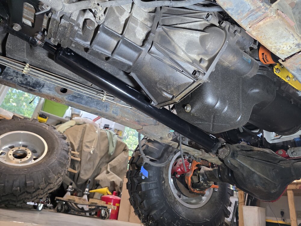

I took the front driveshaft to Olivers to get it extended. I feel shorted though since I didn't get a cool sticker like Stretch did.

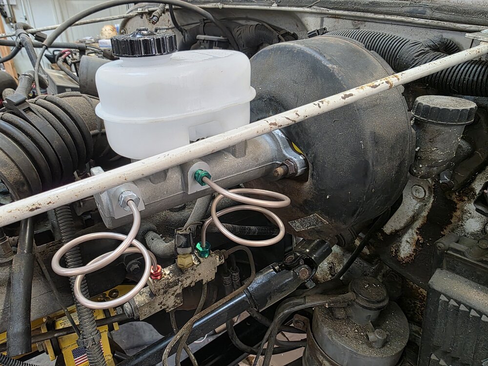

I've been messing around working on brake lines too. I need to buy a flaring tool. I also need to buy a bigger master cylinder. The internet says a Dodge Ram 2500 is the way to go.
I ran the dodge 2500 master on my YJ and the brakes with 40's is pretty good

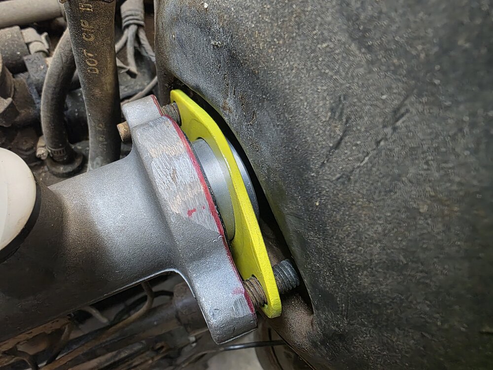

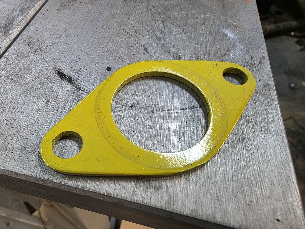

I ended up going with the Dodge 2500 MC. The internet says it needs some grinding to fit on the booster, and that the rod needed to be shortened too. I ground some off MC, but it still wouldn't fit up on the booster. I screwed the booster rod all the way in, and took some measurements from the rod to booster, and on the MC. I determined that the rod was still 1/8" too long with the tip screwed all the way in. I figured I could kill two birds with one stone if I made a 1/8" thick spacer plate. It solved the booster rod problem and I didn't have to grind any more off the MC to fit up to the booster. I then made new lines with some tubing and fittings that I ordered since the fittings on the Dodge MC are on the opposite side from the stock YJ MC, and take metric threaded fittings.

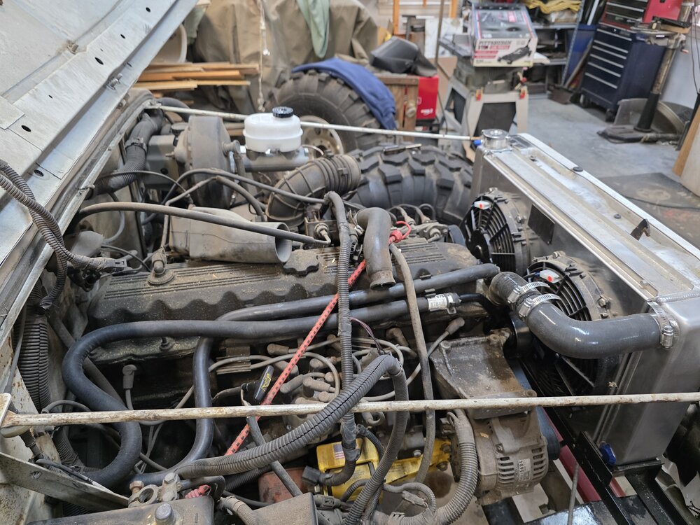

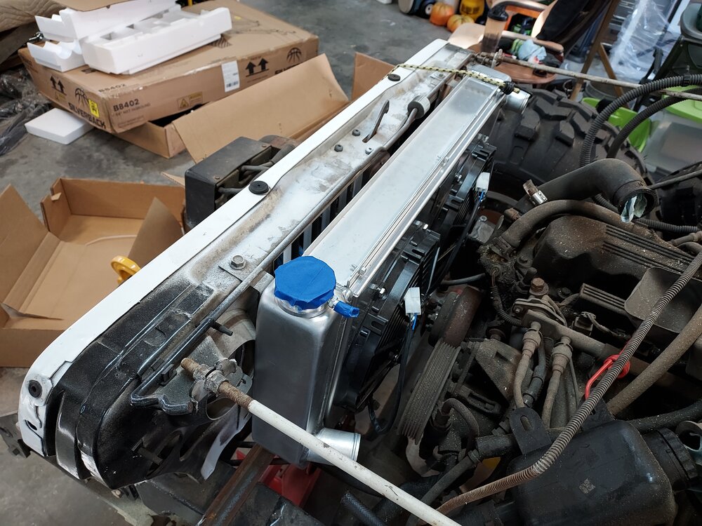

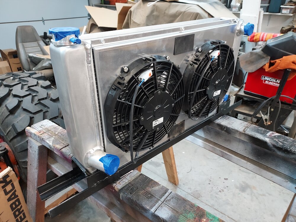

I took off the thermostat housing, and the heater hose port was completely plugged with gunk. I cleaned it up and installed a new thermostat. I also decided to replace the water pump, the hard pipe(rusty), heater hoses, idler pulley, and serpentine belt since everything looked old, crusty, and it hasn't run since 2018. I installed the new custom radiator hoses, but still need to build an upper radiator mount, and weld the lower mount to the frame.
