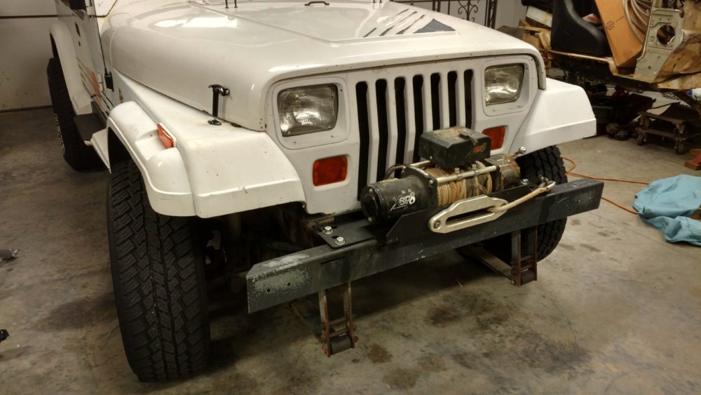

I bought a Rough Country winch mounting plate off Amazon for $70 shipped, and installed the XRC8 winch from my samurai. I also used the in-cab winch control switch from my Samurai. One of the hood latches was missing, so I installed a new pair. I'm ready to go to Uwharrie and do the 2 wheel peel with these Wal Mart all terrain tires now.

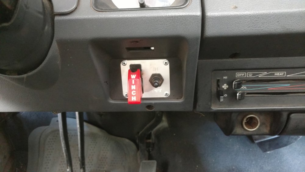

This seemed like a good spot to mount the winch control switch:

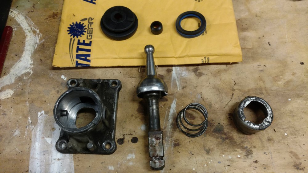

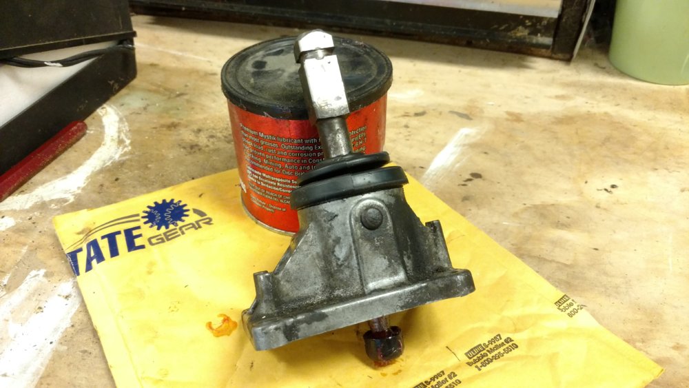

As I mentioned earlier, the transmission shifter felt fairly sloppy. I ordered a shifter rebuild kit from All State Gear assuming the bushings were just worn out. Well, they were more than just worn out. The small cylinder piece that snaps on the ball end of the shifter was completely missing, and so was the round donut part that the main large shifter sphere surfaces rides on! The top rubber seal was torn in two pieces. I also changed the gear oil while I had the shifter off since it is the easiest way to fill it. There was very little in the way of particles attached to the magnetic drain plug, so that is a good sign that the transmission is still in good shape. The shifter feels tight and like new now and the transmission shifts easily.

How did you separate the top and bottom part of the shifter? I know there was a tool specifically for this but have not been able to find a part/tool number or the tool itself. In the past I have used screwdrivers.
I clamped the large round base of the shifter handle in the vice on my workbench with the handle sticking up just like if it was in the vehicle. I then used an old 3/8" extension and hammer to pound on the shifter part shown above. I sprayed a bunch of WD-40 down in the joint first though. It popped right out with a few good hits. I pried on it with screwdrivers first, but wasn't having much luck.

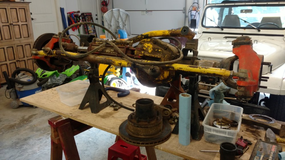

I brought my D60 from the shed back to the garage and started taking it apart. The carrier was welded by the previous owner, and that is how I ran it when I had this axle in my old Ranger cab truck. I'm going to change it out for a Spartan locker.

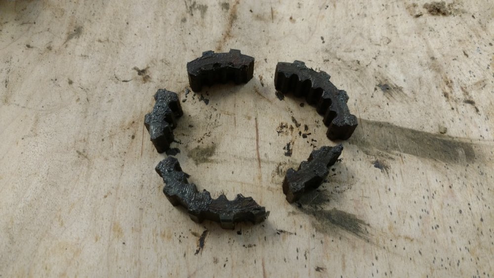

I finished taking the front axle apart, and found a broken hub gear inside the passenger side Warn lockout. I'm considering upgrading to Yukon HD locking hubs. ECGS has 10% off for the 4th.
All you gotta do is push the retainer down and turn CC about 30* and it'll pop right off. I use a decent sized Snap On pick/hose removal tool to do it.
Works like a champ

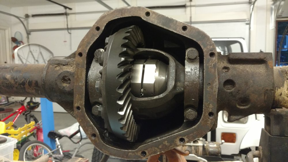

I Made a little more progress on my front axle. I swapped the ring gear over on to my spare open carrier, installed a Spartan Locker from ECGS, and got it all installed in the housing.
If that is a Warn premium hub lockout, it should have a lifetime warranty. Bring all the pieces to an authorized Warn dealer (Advance Auto), they should be able to get a brand new one in a few days for no cost.

I went ahead and upgraded to the Yukon hubs, but will try and warranty the Warn ones and either keep them as spares or sell them.

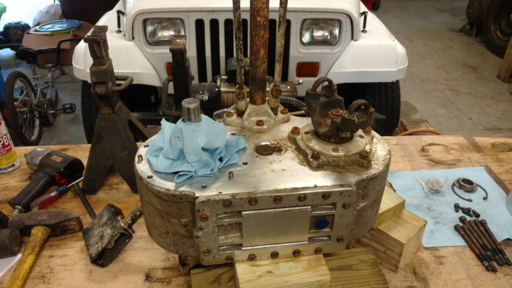

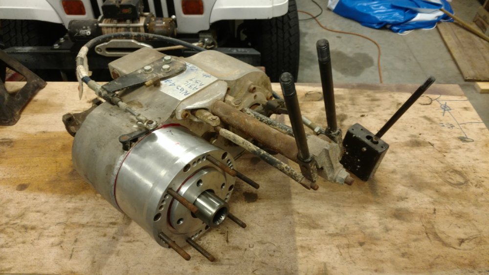

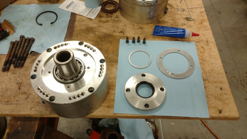

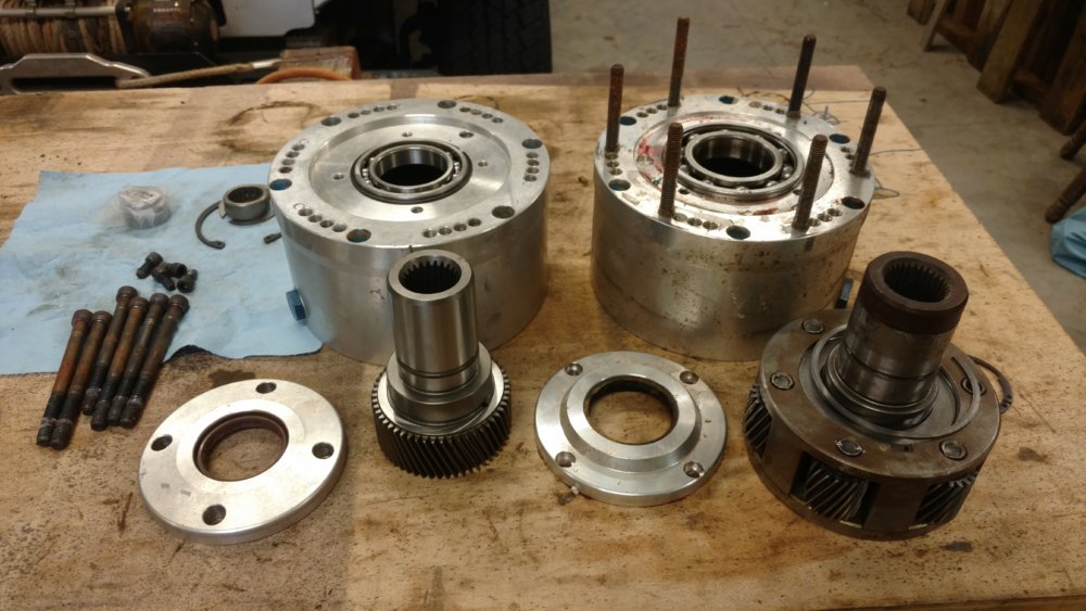

I bought this Atlas 4spd transfer case back in the fall of 2006 to go behind the C6 trans in my Ranger cab truck after breaking 2 or 3 NP208's. I kept it when I tore that truck apart and scrapped it. I want to run it in my YJ, so I needed to change the input shaft. A call to Advance Adapters provided a new input shaft , input shaft bearing, bearing retainer, input shaft seal, c-clips, and front planetary housing. The input shaft required for the AX15 is smaller than the one for the C6, and required all of those parts to be swapped out. For some reason the front bearing retainer seal was contacting the C-clip on the input shaft, so I had a friend cut a couple of spacers on the laser. It is ready to be swapped in now.

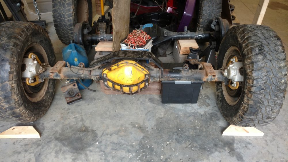

Might as well get started, so I brought the replacement for the turdy five from my shed to the garage. It has a Detroit locker with 4.88 gears, and a disc brake swap. It also has a Blue Torch Fab truss that I bolted on 11-12 years ago when I thought that I was going to four link the cab truck. I need to cut the spring perches off, but that is it. I might buy a Motobilt 13 bolt cover.

I'm going to move the rear axle back 6".
