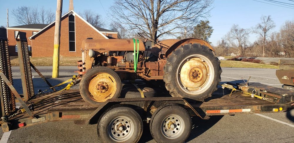

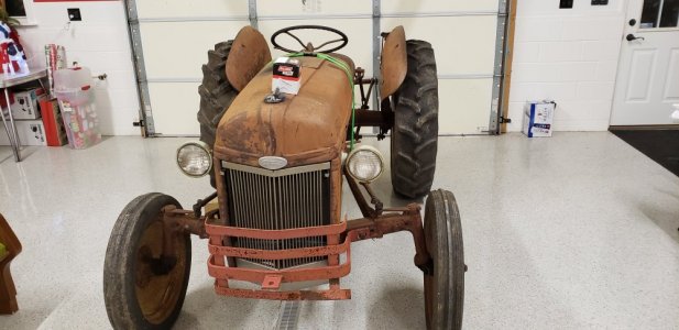

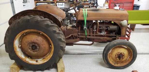

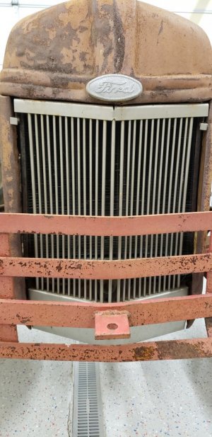

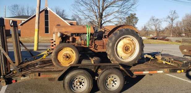

We present the newest addition to the BRF herd! Maybe down a little in the cosmetic department, but at 70 years old, what/who isn't?
In the "plus" department, it's meant to be repaired (versus replaced when broken), so with a little over 1/2 MILLION made, comes with huge cult-like following/support network, all the parts are available VERY AFFORDABLY to the point you could almost build one (aside from engine blocks, but thats what Funk & flathead V8 conversions are for
šŸ˜‡
Plan to get it running reliably (came with 12V conversion/full wiring harness, new plugs, new wires, new carb, and Service/Parts & Assembly manuals), loosen what's stuck/tighten what's loose, change the fluids and PUT IT TO WORK!

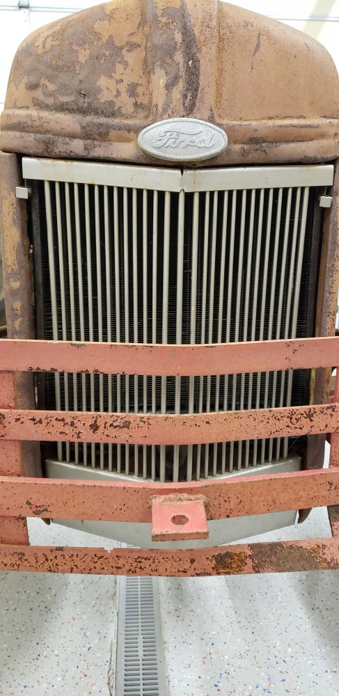

Will likely ospho the rust thru (left/front side of hood is the only spot), the SS grill *WILL* get polished, and that'll be the end of any beautification efforts! šŸ¤£

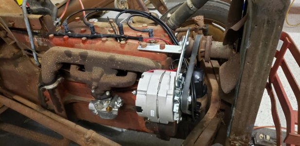

First thing on your list should be a generator to alternator conversion.
Yeap, came with a Dennis Carpenter conversion kit... alternator, brackets, belt, 12V coil, and full wiring harness. Was going to get a 12VDC battery Sunday at Rural King, but the interwebs weren't aligned on physical size, so will measure the actual space and go from there.

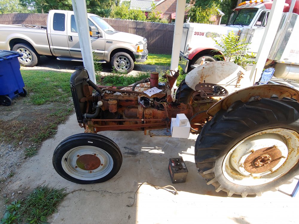

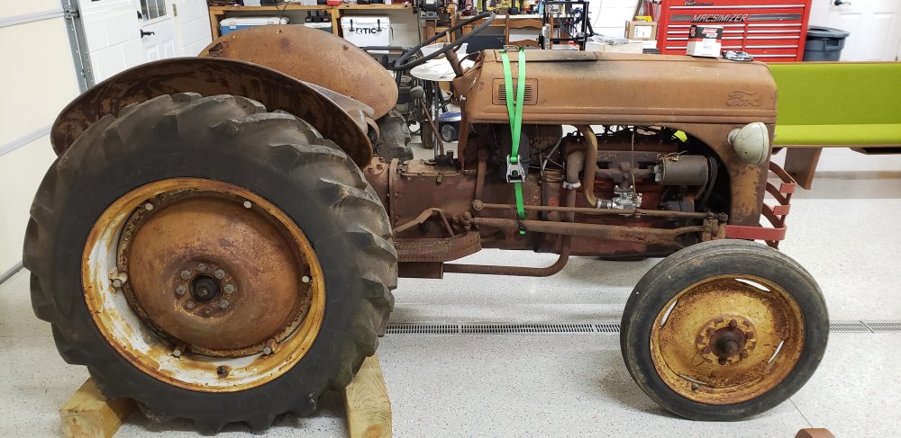

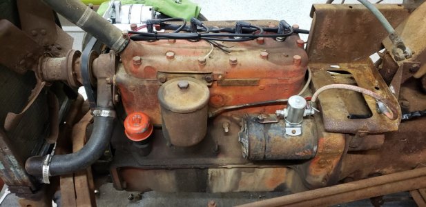

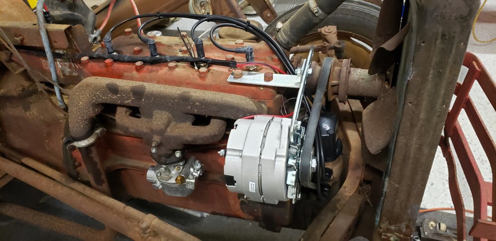

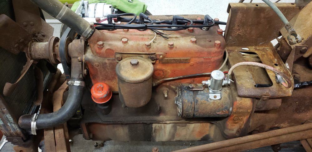

Spent a few hours Friday afternoon pulling the plugs and giving the bores a liberal dose of ATF and several hours later, was able to turn the rotating assy. by hand!

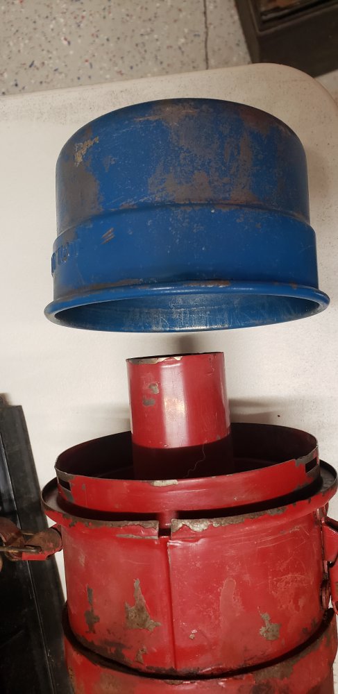

My BIL came over from Topton, so we spent Friday PM/Saturday AM pulling stuff off... battery, hood, old wiring, remaining 6V components, oil bath filter, etc. (the later took about 1.5 hours in the parts washer to fully de-funk). Then installed the new harnesses, 12v solenoid, 12v coil, cleaned/re-gapped the points and had fire! Then gapped new Autolite 437 plugs, new wires laced and with got it to fire with a couple snorts of starting fluid! Didn't have oil pressure, so stopped... many say to pull the pressure relief plug/spring/plunger to fill the oil pump to prime it...
Had other things on the agenda today, but managed to grab a new Group 35 battery (thanks for the tip @baggednissan ), new battery clamps, and couple things for the lights (who'd have thunk that AdvanceAuto would NOT have a single headlight switch? šŸ¤¬)
Will get back on it as able... was great to hear it purr (minus any bad noises)!

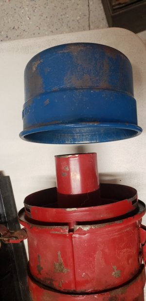

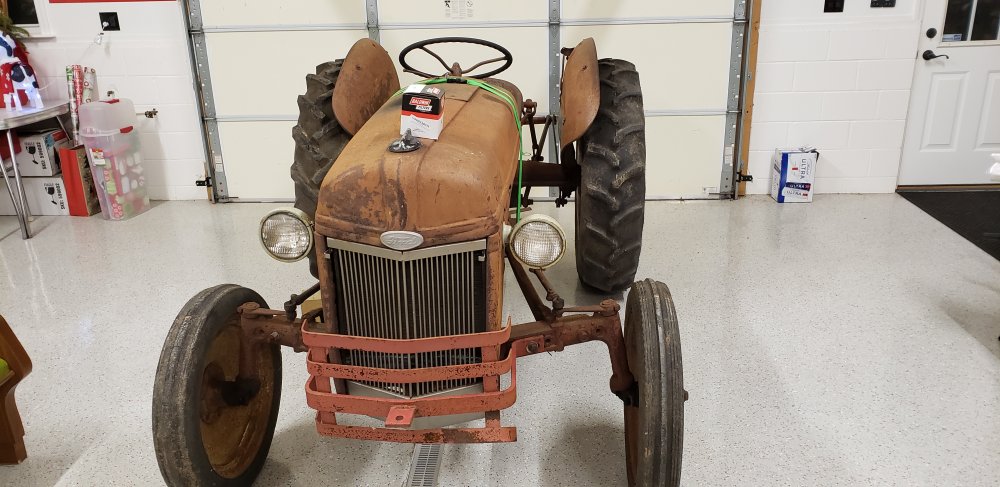

Got the new battery installed, new eyelets crimped onto the existing battery cables, removed the headlights (they were flipped w/ drain holes up šŸ™„), cleaned up the intake pipe (about 50% chrome/50% rusted), mounted the aircleaner and primed the oil pump! Wanted to see if the "new carb" worked (alloy job came with tractor) and got it to run on gas! Ran great, but guess the coolant was low and it got got warm quickly (had been running for 6-7 minutes) and let the steam out. Added 1.5 gallons for the next time (once the hood w/ fuel tank and lines are installed)...
My son came up last night, so making good use of his back, we got the hood set back on and the fuel line re-installed...
Decided to roll it outside (still a lot of drips burning off), add a gallon of fresh no-ethynol to the gallon of stale 5 year old fuel (the oldtimers claim it will burn in the 6:1 compression) and see if it'd fire. Took a few tries before the fuel made it to the bowl... but it started!
Since we couldn't leave well enough alone, decided to give it a test drive! The PTO spins, the hydraulics work (even in <40* weather), the brakes did well, didn't overheat despite what I believe is the original radiator & 0# cap... and I was grinning the entire time!
Still have some "cleanup", more parts to reinstall, and full fluid changes to go before starts getting the beatdown!
