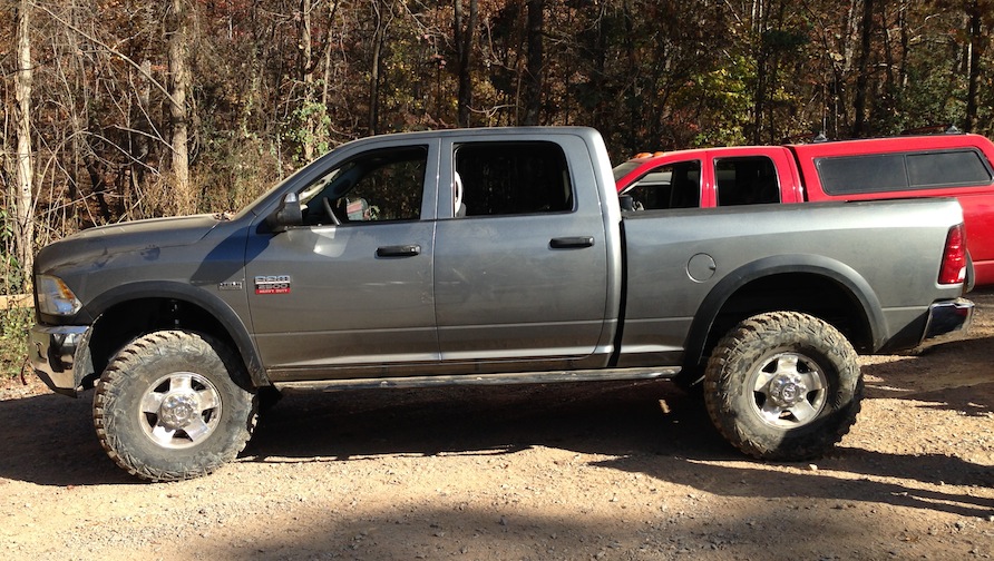

A K5 too big for Uwharrie?!?! Nope! I wheel this whale there, a K5 fits more than fine! (before anybody calls me out on all my dents, they aren't from Uwharrie, the only dent from Uwharrie is one on my back bumper from when I was moving out of somebody's way and was dumb enough to hit a tree, LOL!) A full size is a bit of a challenge at times but, quite fun!

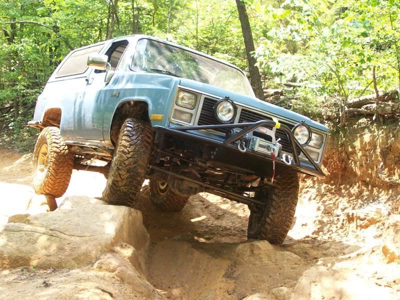

That being said, I miss the heck outta my old full size K5 Blazer!!! (mine was a Jimmy but, same thing!) It did GREAT at Uwharrie!!!:
ai253.photobucket.com_albums_hh43_biglightblue87_House_20and_234778f8128348136a93bb8242037e783.jpg
They are VERY easy to build up!!! Dana 60 front and K-20 14BFF rear will bolt right in (K-30 14 BFF (such as CUCV) will require moving the spring perches on the axle), parts interchangeability is CRAZY good! Mine had 350 TBI, SM465, 203/205 Doubler, CUCV axles. (simplified list, a LOT of goodies) A 3" lift and some fender trimming will have you running 37" tires easily! They make awesome trail rigs!!!
Issues:
Steering box area of the frame needs reinforcing!
10 bolt rearend is a ticking time bomb, lol!
Stock steering setup sucks so plan on crossover steering!
The prices on them are climbing! (a couple years ago when I sold mine I could barely give it away, now a mediocre one is as much as what I sold my built one for! Deals can be found still though, just gotta be patient and search for them!)

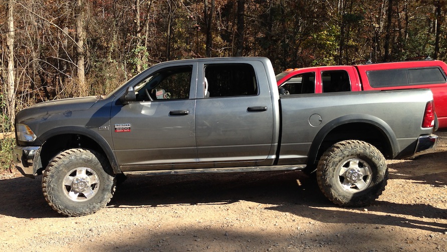

06redwagon- I wish I'd have thought to say that- look, there's another Power Wagon wheeling at Uwharrie too!!! Something to the effect of- if these two fit, you know a K5 will!!! LOL!
