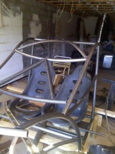

i rolled some tubing today..no pics to prove it:rolleyes:

what kind of roller you using?
a manual roller..keeps me thin..LOL
Brand? was the specific question? I figured manual unless u got 10K or something to spend.
The tube radius look clean btw.

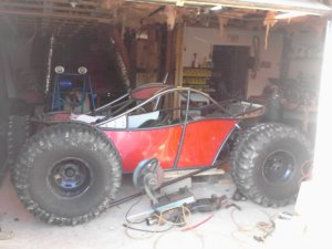

but the skins are on it

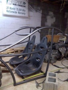

Looks good, I'd suggest getting some better seats though, your back will be hating those plastic ones.

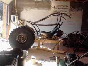

Ok,,,,,,,,,,,,,,heres one.i had a sammi axle on 33s laying around for perspective..at full bump..

-I have the rear toyota steerable axles knuckle balls cut off the housing,getting it ready to flip the housing for pass drop in the rear(4 wheel steering well on the way.
