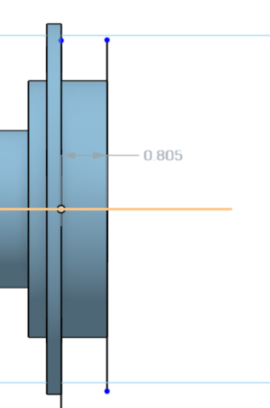

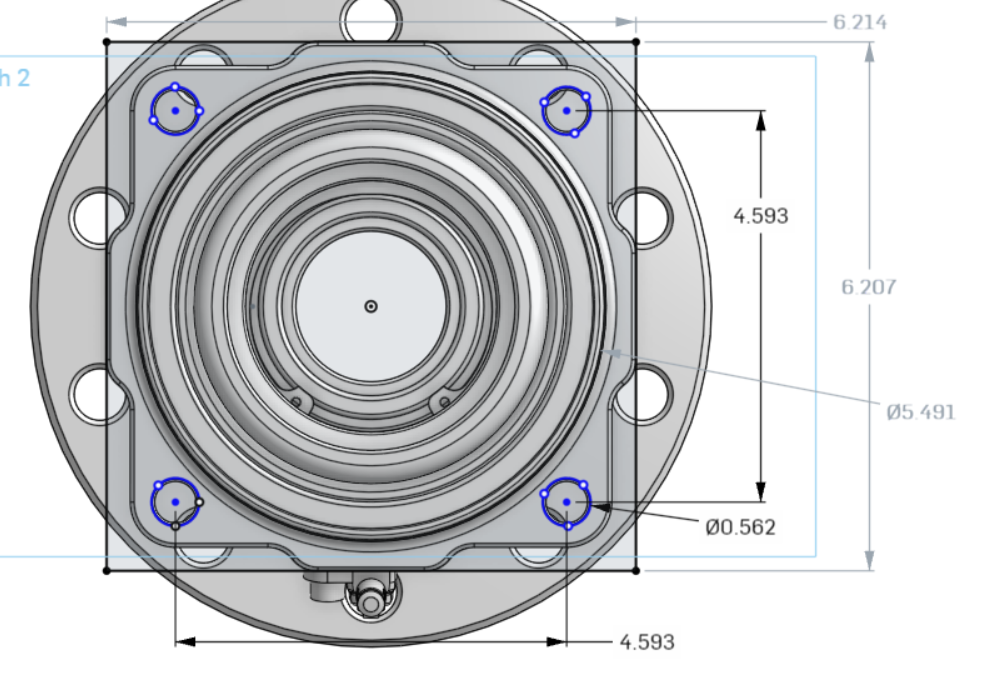

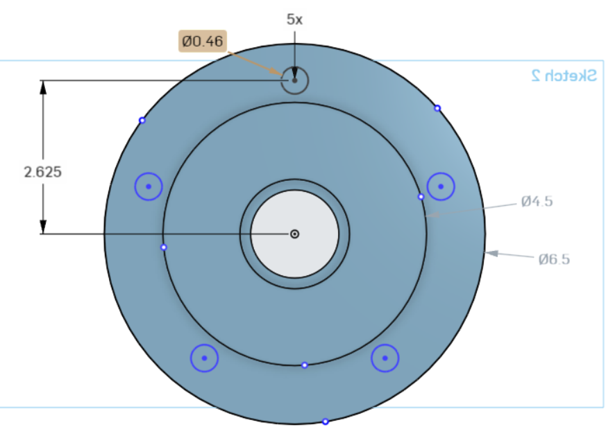

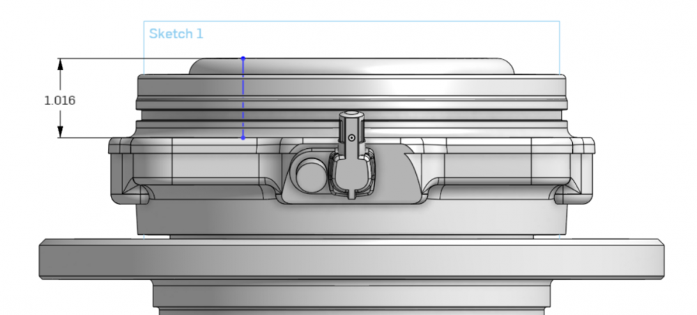

I took some measurements off the CAD models that I have. Looking at them, you would need a 0.211 spacer behind the UB, to put the rear seal in the same basic position. You can see the dimensions of the rear of the UB to make the spacer. Basically would machine a hole in the knuckle, taking out part of the existing holes. Could drill the knuckle for new studs/bolts and weld the plate on if you chose. Not sure how brakes would work.
