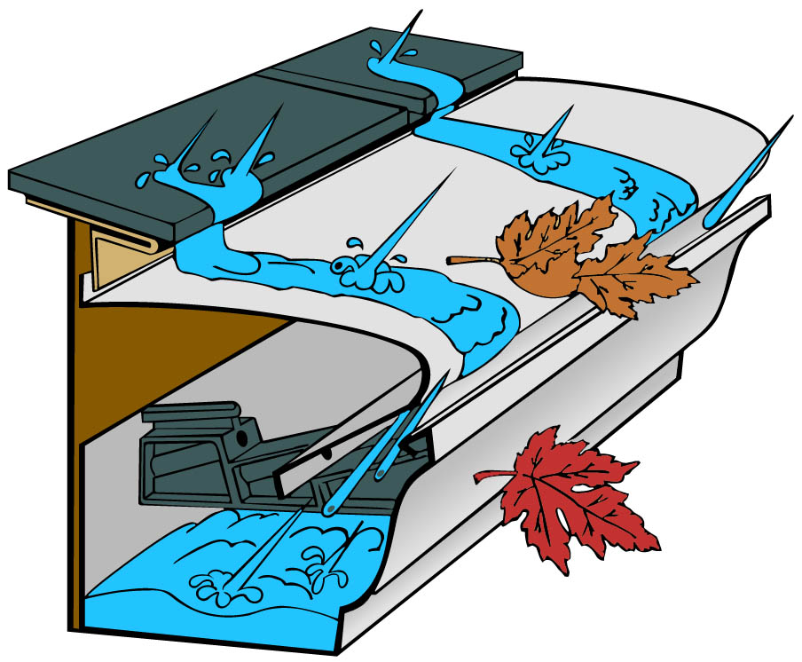

i have come to the conclusion that the only ones worth getting are the ones that look like this
they are too expensive for my budget however, so i have not tried them and just get the ladder out every fall and spring...
i would rather have other toys and just manually clean them... i do only have a single story house tho.. if i had some really tall scary shit to clean things may be different

I had the helmets on my old house. They worked great but do need to have the rounded surface cleaned once a year or so to keep them working properly.

Gutter helmets
Gutters..
The quote to put the gutters with the 'helmets' over them was $6500 more than the quote for regular old K gutters.
I can clean a shitload of gutters for $6500.

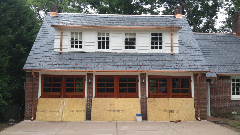

This won't clog. I'll finish them up Monday and can swing by Tuesday to start yours.
This won't clog. I'll finish them up Monday and can swing by Tuesday to start yours.View attachment 218747
:huggy: Can't hide money when it's literally hanging of the front of your house....
Is it me or does that roof look like it has a dip in it? Could just be the slate messing with my eyes....
No it has a terrible dip in it. They installed a 16" I beam in the garage and jacked it some. Should have seen it before that.
Between the house and garage they have about 600' of gutter and 400' of downspout. Actually one of the smaller copper jobs we've done lately. But I could about pay off my house for what they have in new gutter.
Damn....
