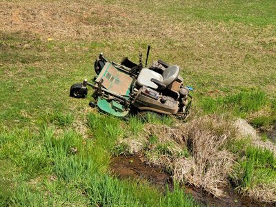

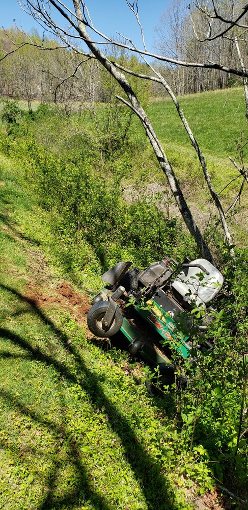

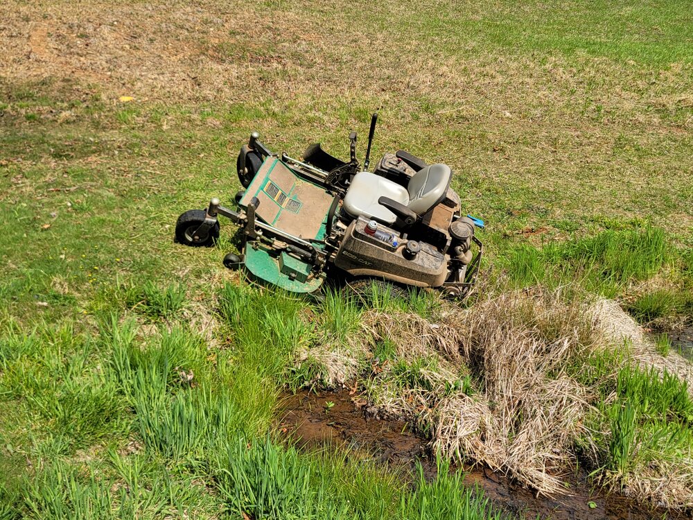

If you're not riding the hills like this...are you even mowing?
I've been this guy many times. Bypassed the seat weight sensor so it wouldn't shut off on da hillz.
