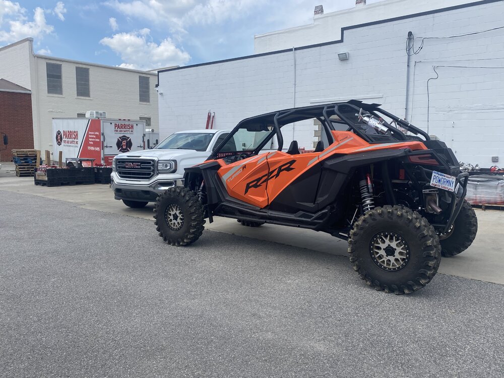

I have a 2.5lb Halotron in the cab and 2.5lb ABC on both back roll bars. All on aluminum quick release brackets. The $20 ones on Amazon have been tested on our race team SXS in King of hammers and performed great. Just have to locktite the pin and knob on.
