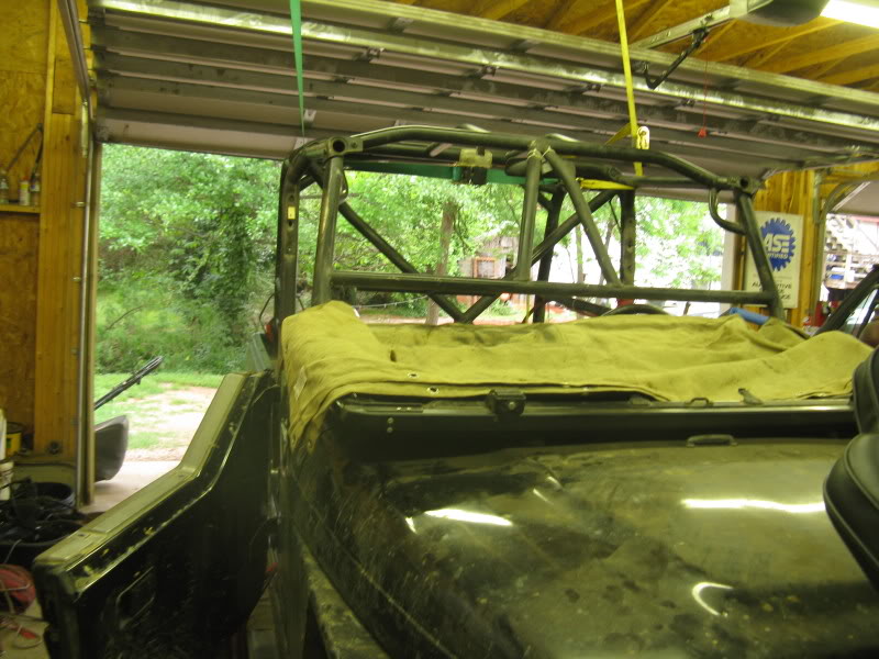

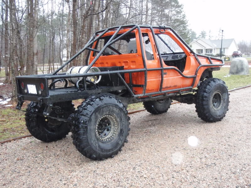

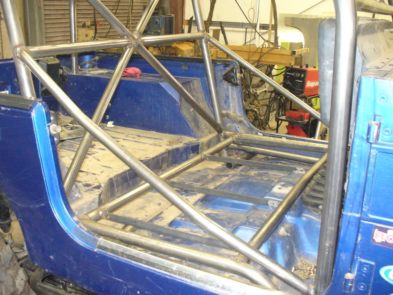

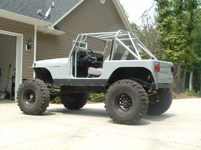

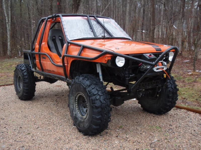

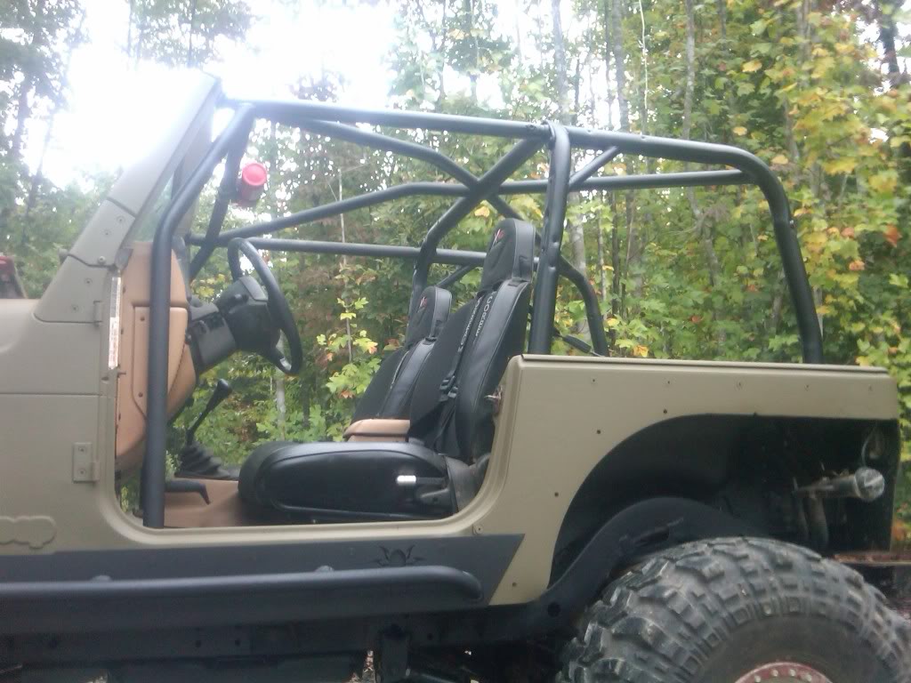

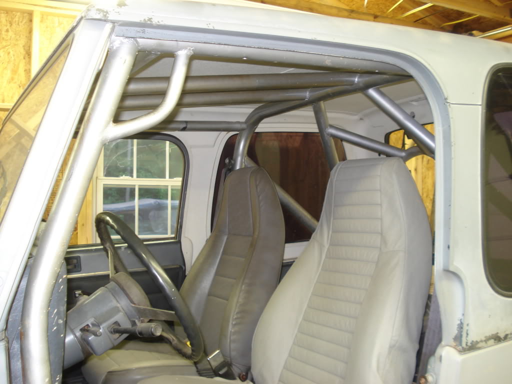

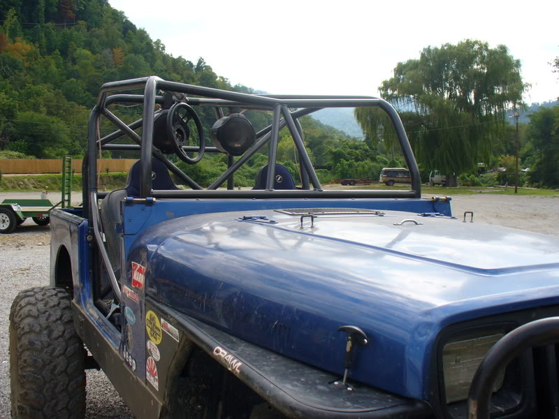

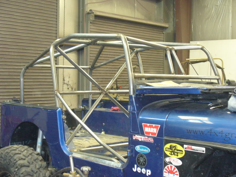

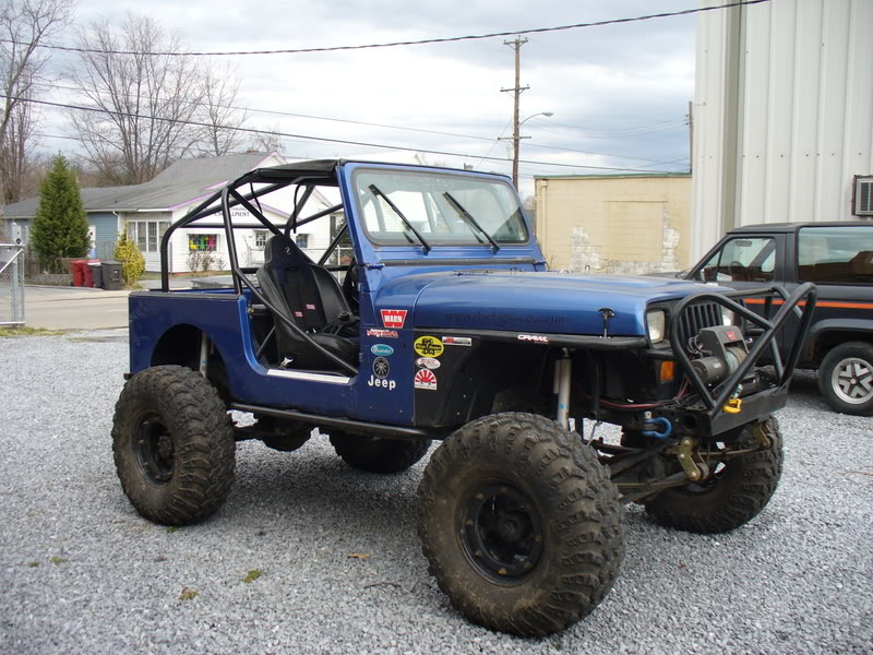

Here's a couple I have built:
Nope all of them are 1.75. For some reason certain cages look like that, I know what you mean it does look larger. I think papajon has a picture somewhere of it all painted.

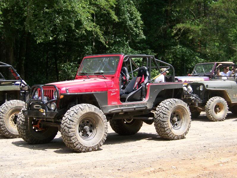

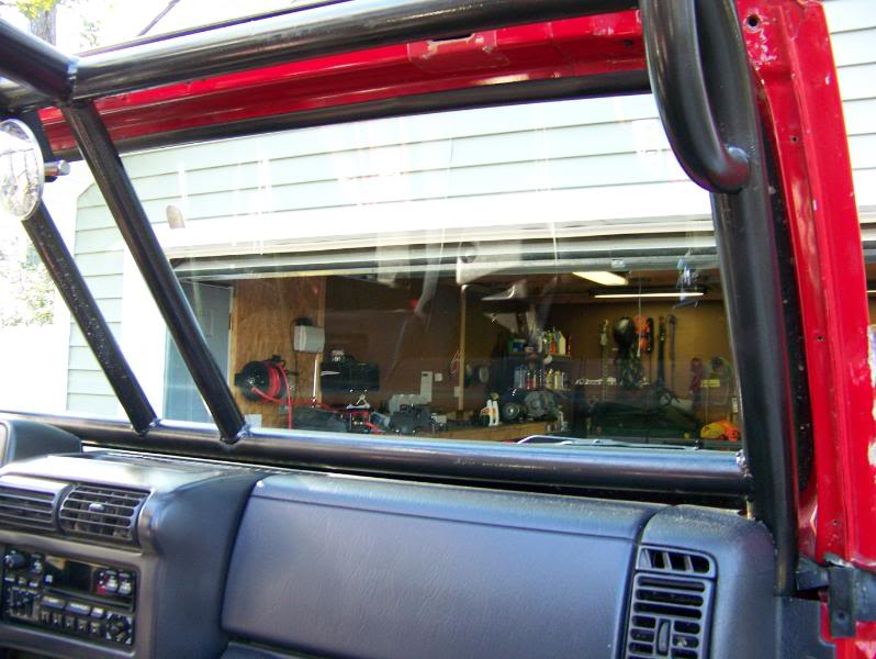

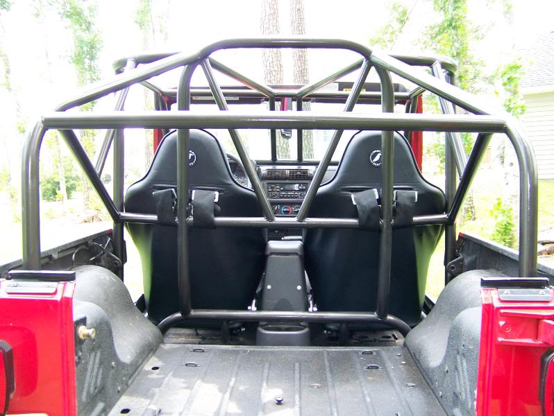

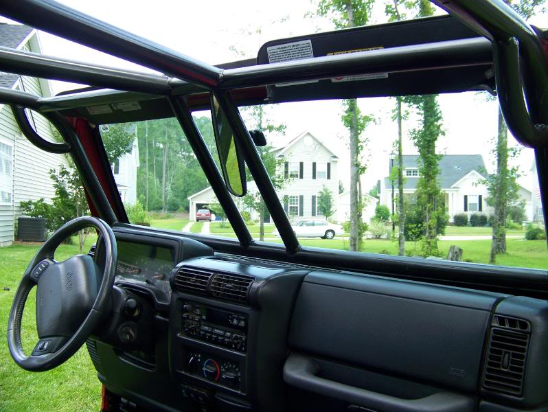

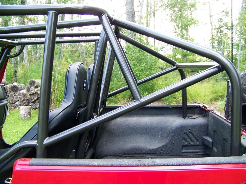

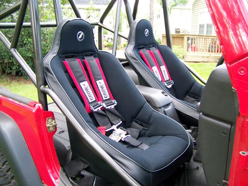

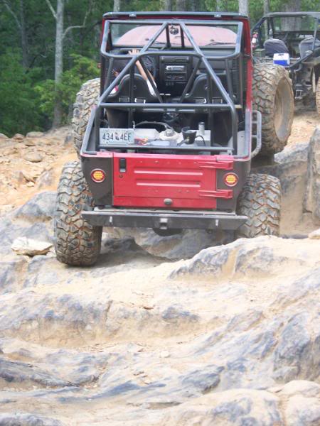

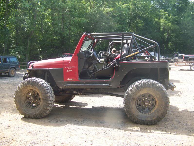

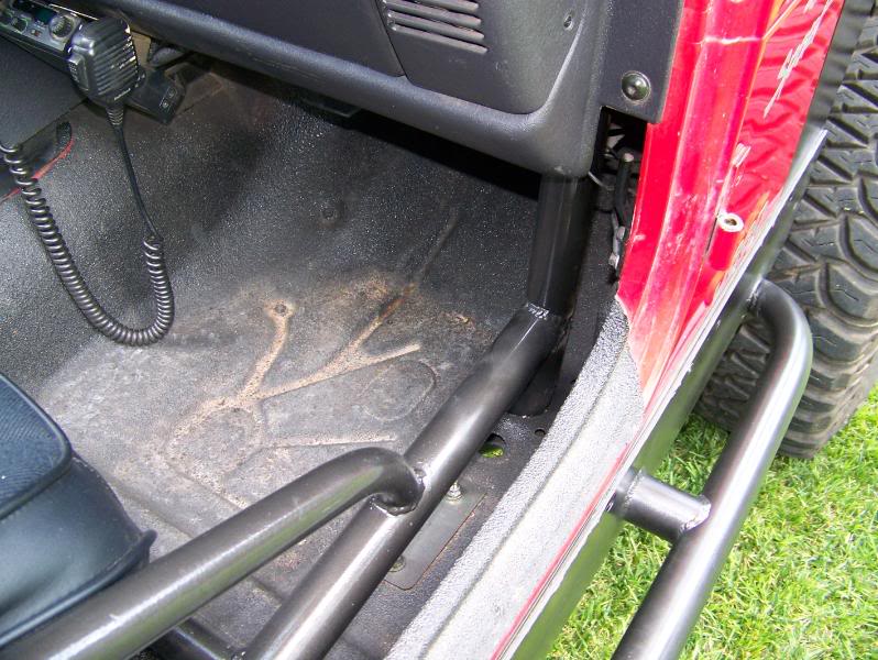

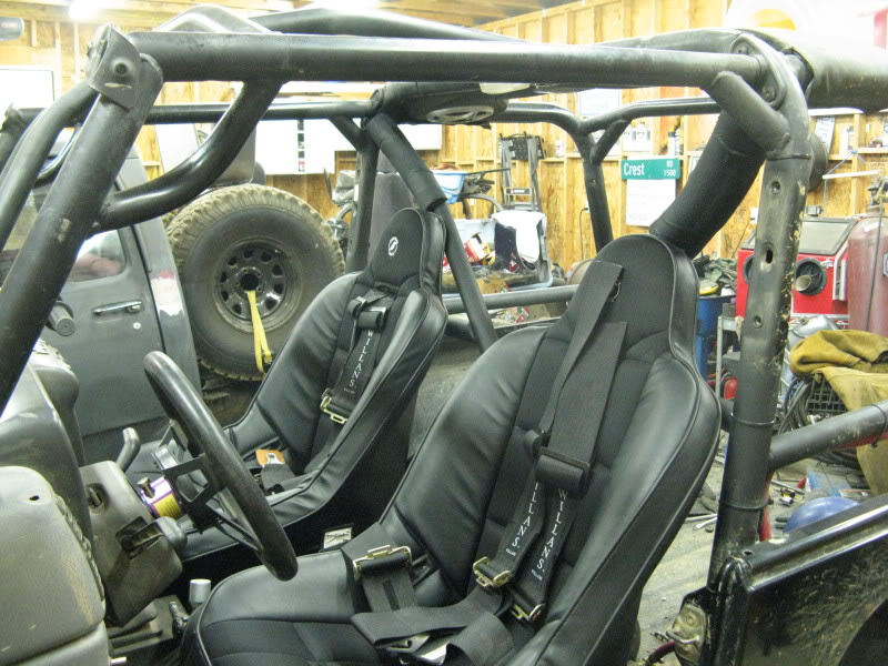

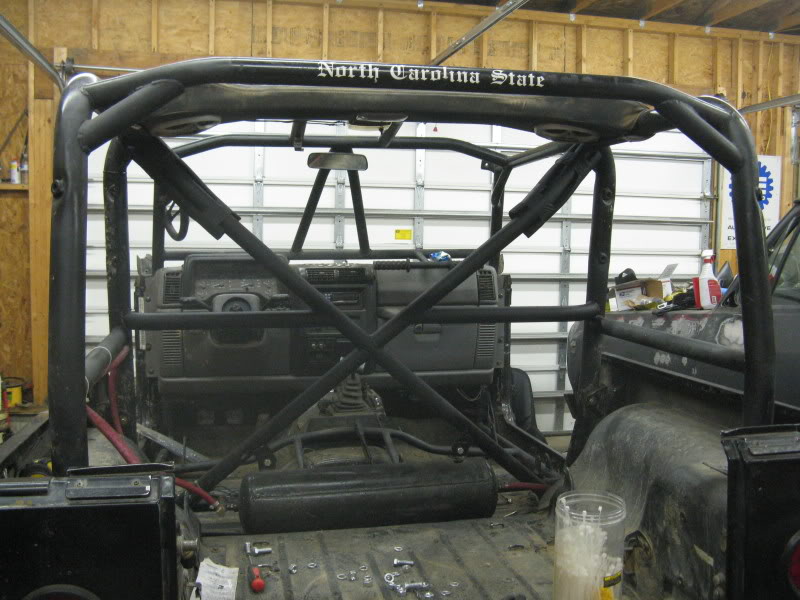

I wanted something really different when I had them do this TJ cage. I didn't want the same cookie cutter design, and I also wanted a large amount of leg room and headroom. I told him however you want to do it, then do it.
All .125 wall dom, floating floor, (and the harness is bolted behind the seats to 1/4" plate right at the opening for the belt slot in the seat, just in case it looks low in the pictures). The cage is hard tied in at 6-points. Overall Im well pleased with its design, I feel nice and safe, and I like the looks of it. Good luck with your build.

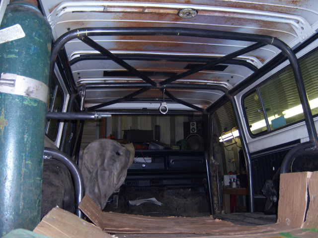

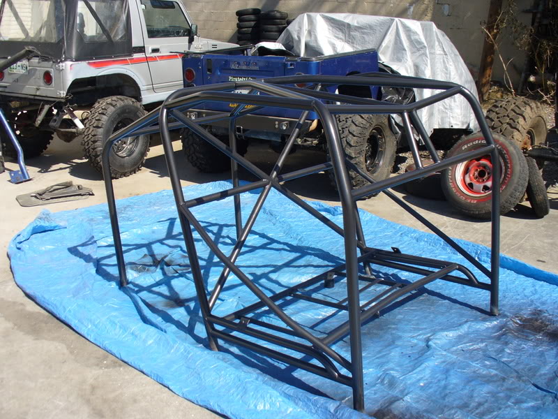

my junk. built by the midget at UFAB...
:lol:
