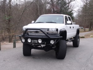

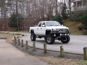

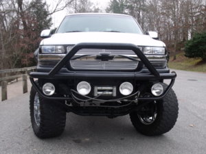

2002 2500HD Duramax
SAS'd with 38s (currently). Prob gonna move to 40s.

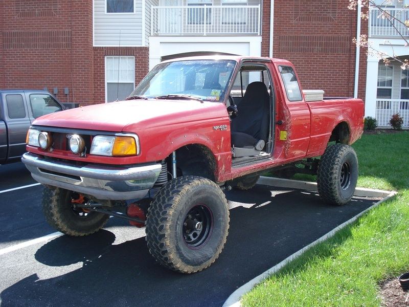

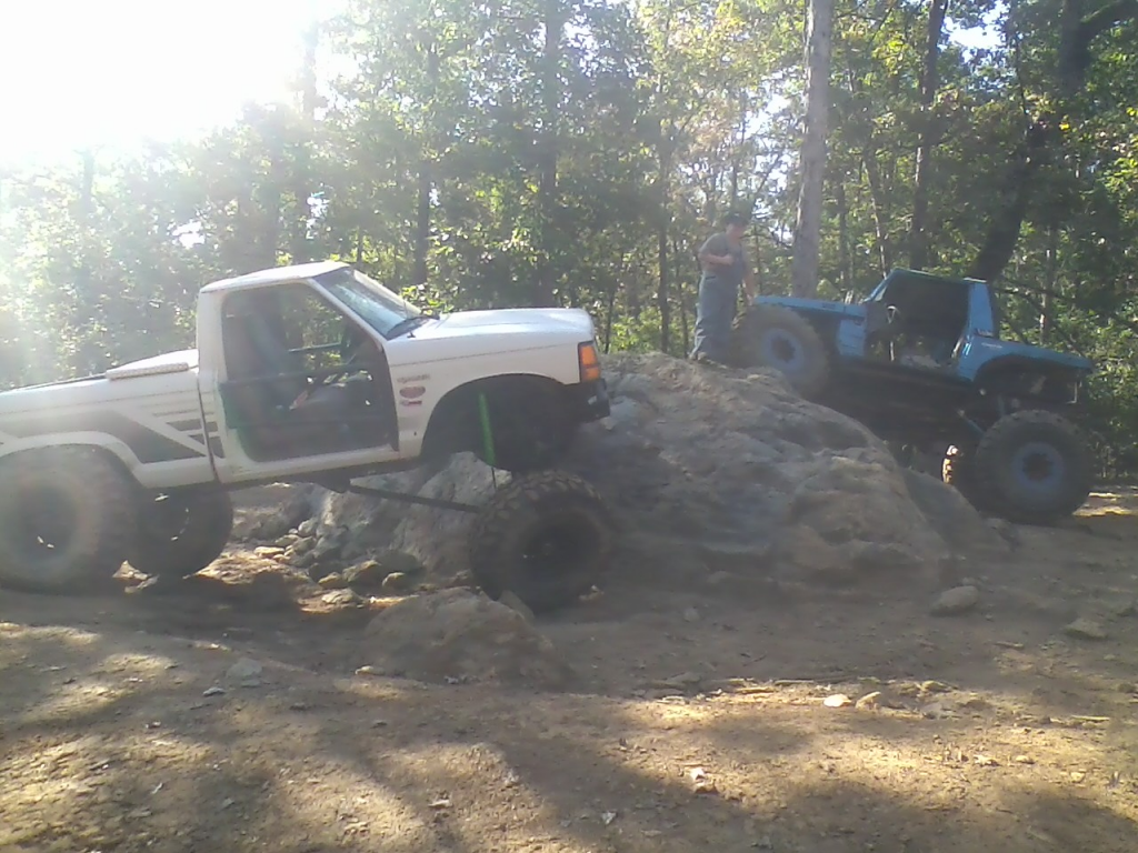

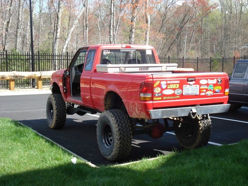

Sweet ranger dude

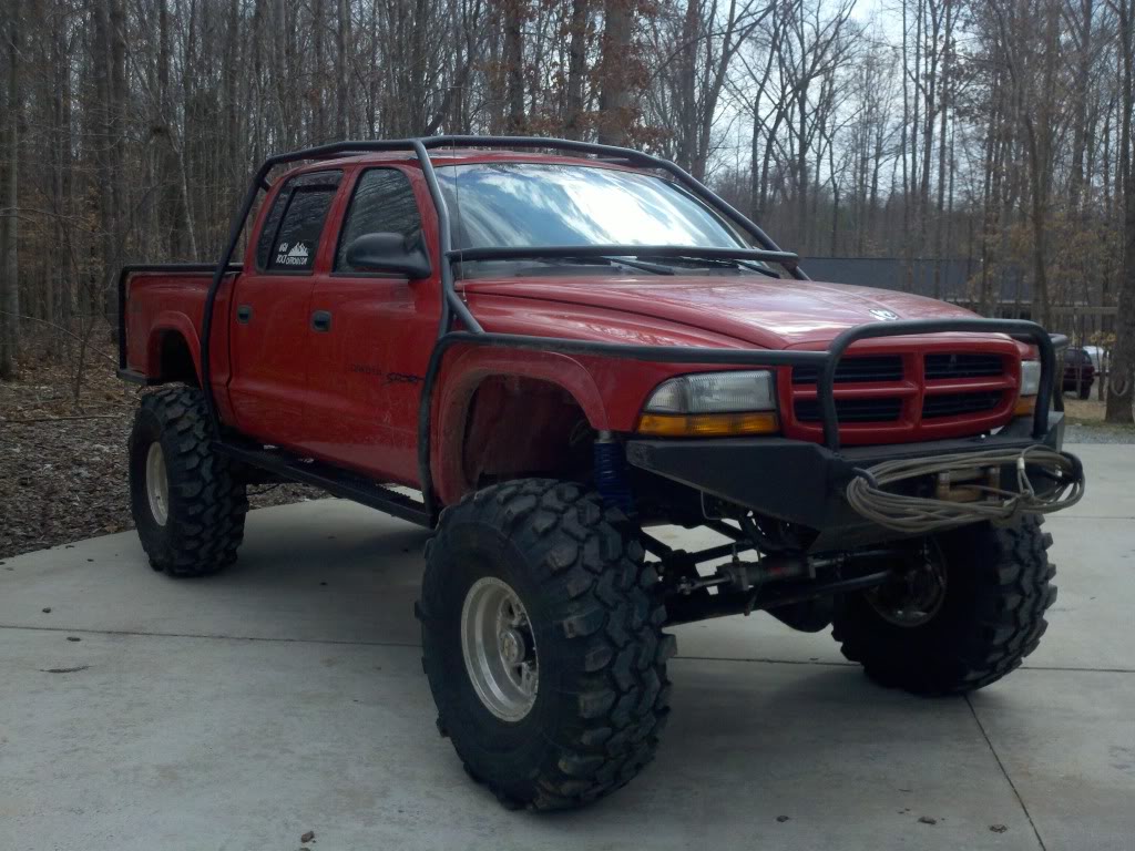

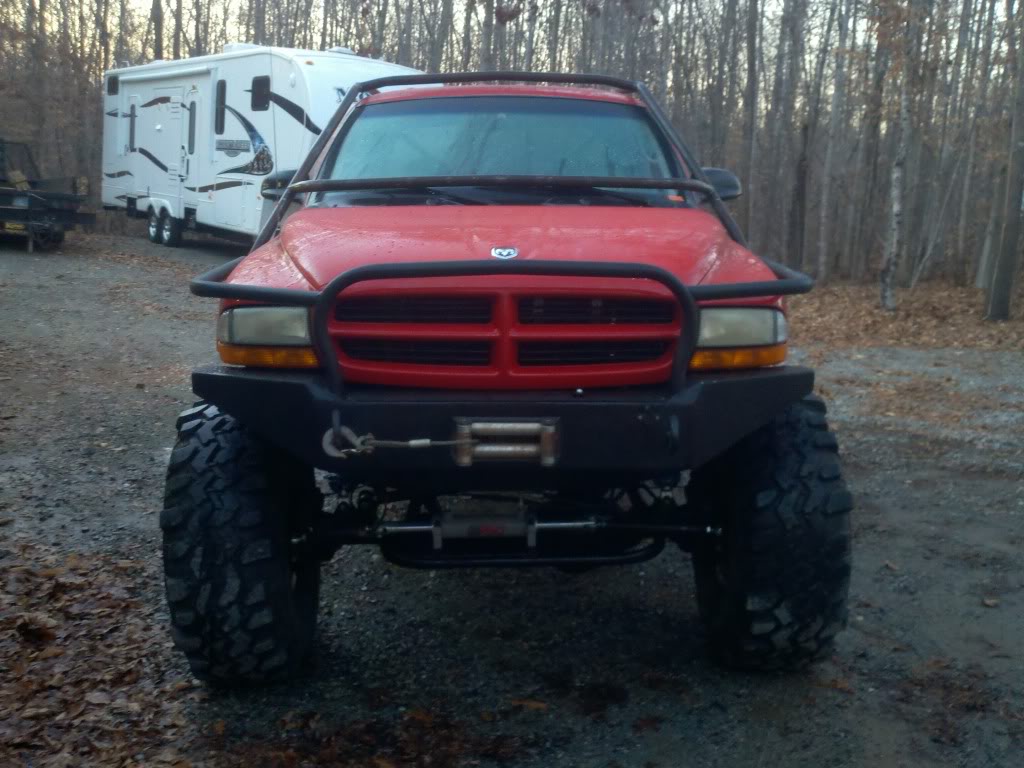

Okay, I'm in. Here's my 2001 Dakota SAS'ed.
ai239.photobucket.com_albums_ff33_sqrlmoney_Fab_20work_Dakota_20SAS_2011_02_27_13_49_37_790.jpg
ai239.photobucket.com_albums_ff33_sqrlmoney_Fab_20work_Dakota_20SAS_2010_12_19_17_06_04_141.jpg
Still in progress...

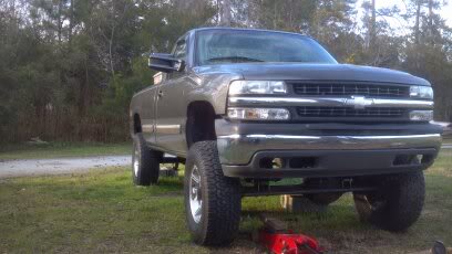

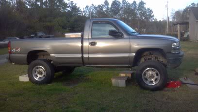

My 99 Silverado 1500. 4.8, 5 speed and an NP241 with a JBC SYE and 1410 rear shaft. Used a 79 Ford 60 and an 02 2500HD AAM 11.5 with 4.10s and 35s.

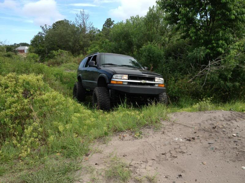

Before at Carolina Beach:
During/Testing:
After at Gulches:

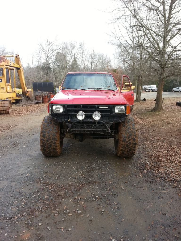

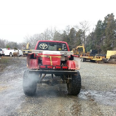

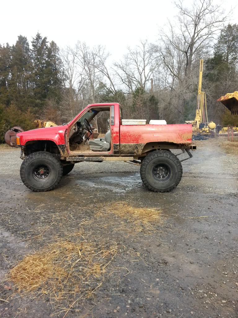

86 with 85 axle ruf tundra springs outback 22r duals spool front and rear 4.10 full hydro done soon once i get my ram in
How do those tundra springs work? Never heard of anybody running those. Rig looks awesome though.
Sent from my mobile Toyota base using Tapatalk
they work really well stiff at first but now the flex well and are stable, theyre 56" long and i used the same shackle mount and moved the front spring hanger 9" forward i believe

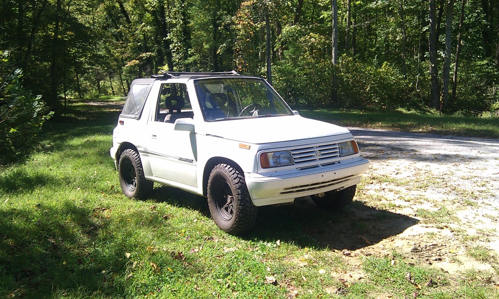

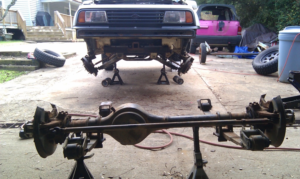

Here mine I did several years ago....small photo sequence...
Bone stock when it was a DD...

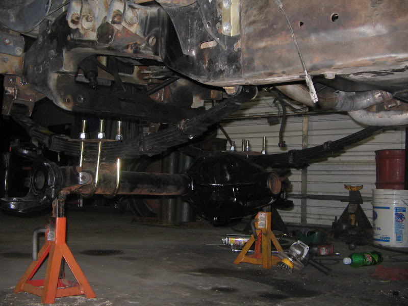

Here is a great view of the IFS...as you can tell the suspension isn't doing alot for me...
On the forklift immediately after the SAS
A little later in it's life
This is how it appears to this day...at this point it was deemed 'finished' (as if that's ever really the case) and work began on the buggy I have now.
