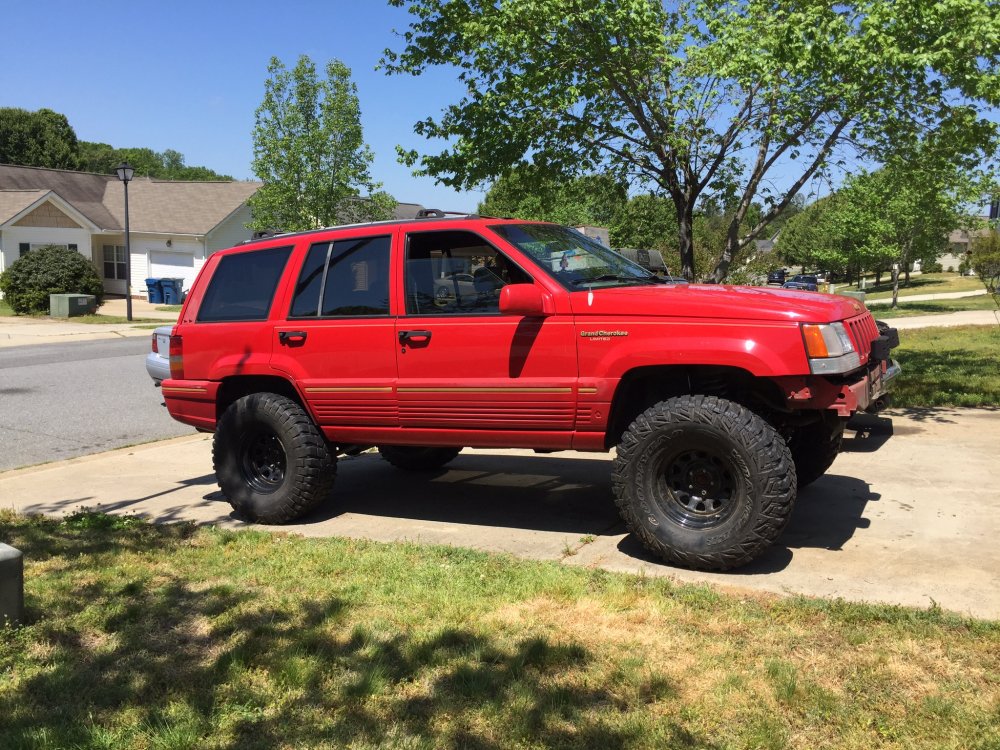

This was mine waaaaaaay back in the day, I had Andy at the Carolina rock shop build it, mainly because my knowledge was minimal and I lacked most tools....anyways, I had 4.5” springs with 2” pucks on top, and 8 adjustable short arms (all maxed out to their ability if I remember correctly) had swapped a 8.8 from a FSB and was running 4.56 gears. No SYE, factory driveshafts, D30 up front and I believe those were 285’s I was running. It did fine for what I used it for which was mostly commuting back and forth to work, the occasional mud hole and then mild things like what’s pictured....oh and front and rear adjustable trac bars as well

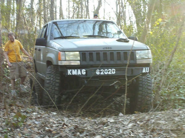

This was a 94 I had not too long ago as well, this was 4.5” lift with front adjustable trac bar, adjustable lower control arms front and rear, and maybe a trac bar bracket on the rear, can’t really remember. But those are 33x12.5x15 on it....this one only ever seen pavement before I unloaded it unfortunately
