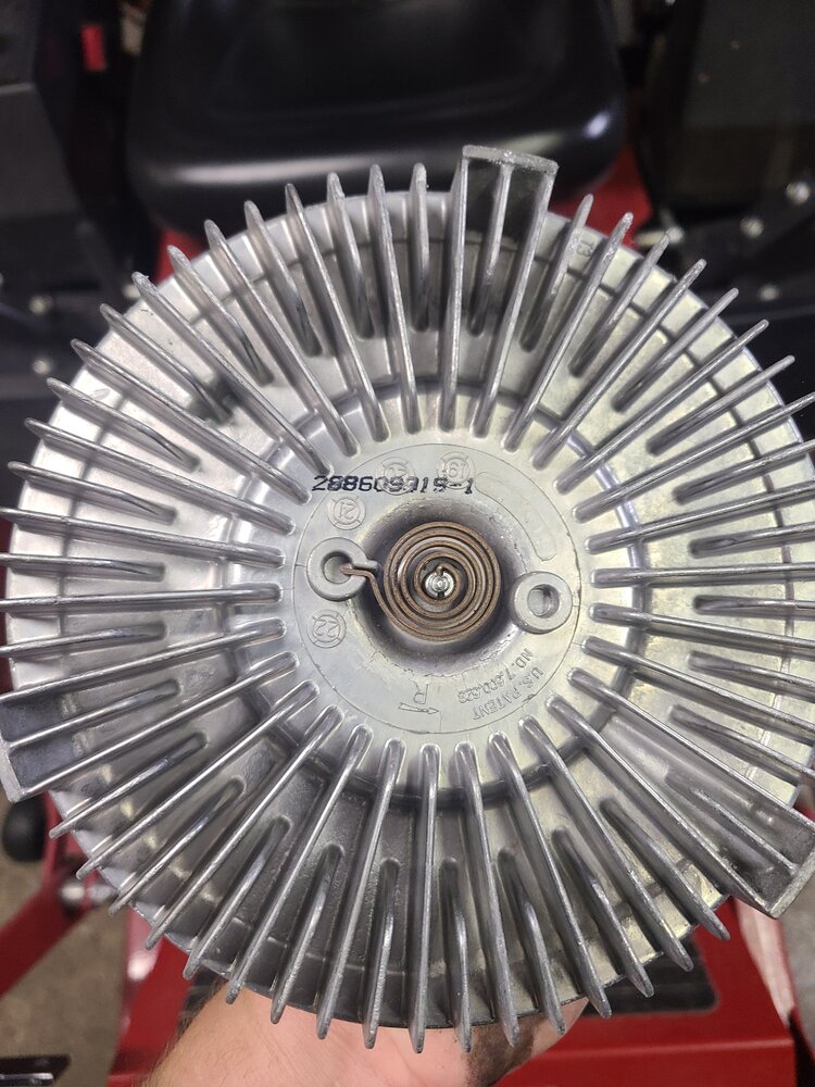

They engage and disengage based on rpm not temp
The rest of your points: very valid, no disagreement. This one though...do huwhatt?
That's what that little bi-metallic spring does 🤷‍♂️
The video he included mentioned a fan with a fluid filled clutch that engages on RPM. Based off centrifugal force.
I saw that...although, I can't think of ever seeing one like that in person. I'm curious to know what application used it.
That said, I do certainly prefer an electric fan myself. I did the 05+ truck fan swap on my 99 Silverado and they're pretty sweet.
Sorry should have specified. Yeah that one statement was exclusive for non-thermal mech fans.
Shoot i think they even make electronic clutches now too!
