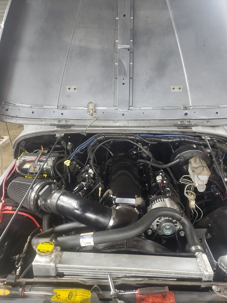

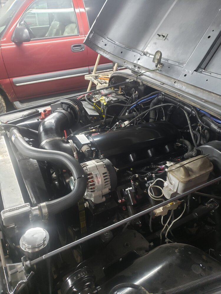

These cheap freaking eBay intakes can kiss my a** lol, they get 1 star for looking good.
Looks like a factory Chevy hose.Did you have to call a plumber to get that many feet of upper rad hose installed?
doesn't look too bad IMO.
so he bought radiator and stuff before we ever met, brought it and said can you make it work. I get a lot of that lol, it sucks, but it is what it is. So sure I made it work, just like the intake, but at their cost and some aesthetics (radiator hose haha). But as you said, it's not terribleI mean, if the goal was classying it up, I'd install a dual pass rad with both inlet and outlet on the passenger side, as you mentionned.
But this will do the trick just fine and doesn't look too bad IMO.
after like 30min of looking, there it was popped up out of nowhere and said to myself "that sucker looks like it was meant for this" LMBO and sure enough it was. I'm not crazy about it but he wanted to make that 400 radiator work so I made it work.Did you have to call a plumber to get that many feet of upper rad hose installed?
Yeah me too, simple, will always cool no matter whatI like that you retained the mech fan. Should cool fine.
unless the clutch fan fails....Yeah me too, simple, will always cool no matter what

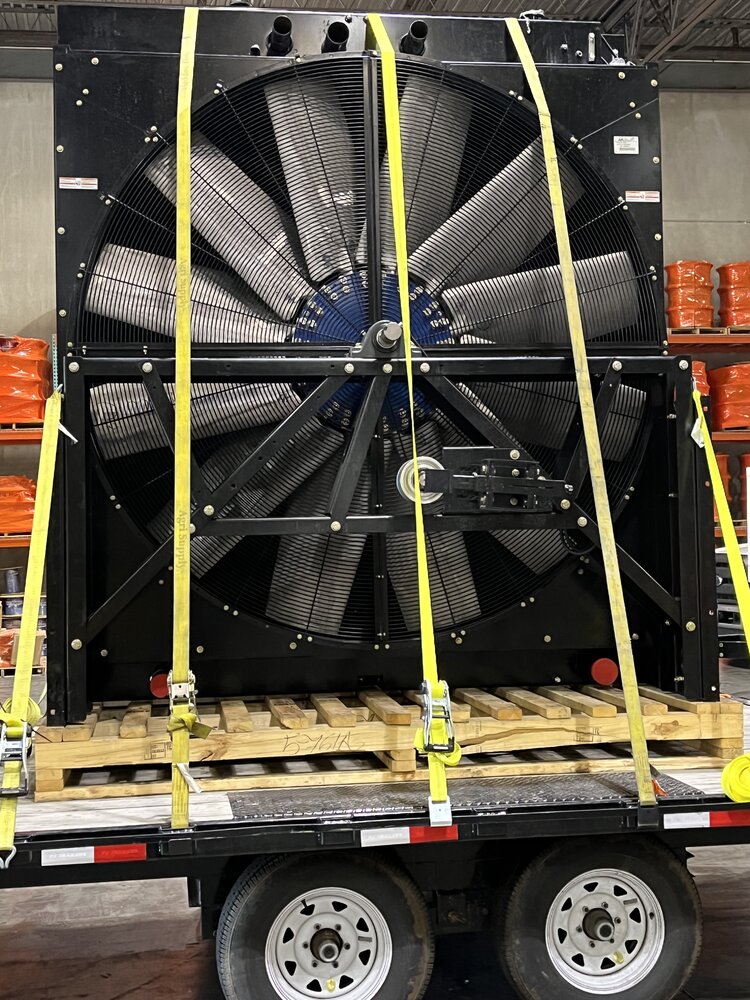

Many fan cfm are in the 2k(-) range. A mark 8 efan is upwards of 5k. Then there is brand new products with even higher specs.
IMany fan cfm are in the 2k(-) range. A mark 8 efan is upwards of 5k. Then there is brand new products with even higher specs.
Hehehe. To stir back just for fun.....I see a tensioner pulley. Guessing belt driven by: Electric motor?Just to stir the pot, Im sitting here working on a cooling system package right now this afternoon and the mechanical fan is 102,00 CFM...you aint getting there with a e-fan....well you could. But youd lose a whole bunch of ekW which kinda defeats the purpose in my world.
But I am dealing with just shy of 3,000,000 BTU/hr of heat rejection to handle
This should handle it
Nah it’s driven by the front accessory drive of a 65L diesel (notice the lack of decimal)Hehehe. To stir back just for fun.....I see a tensioner pulley. Guessing belt driven by: Electric motor?![]()
