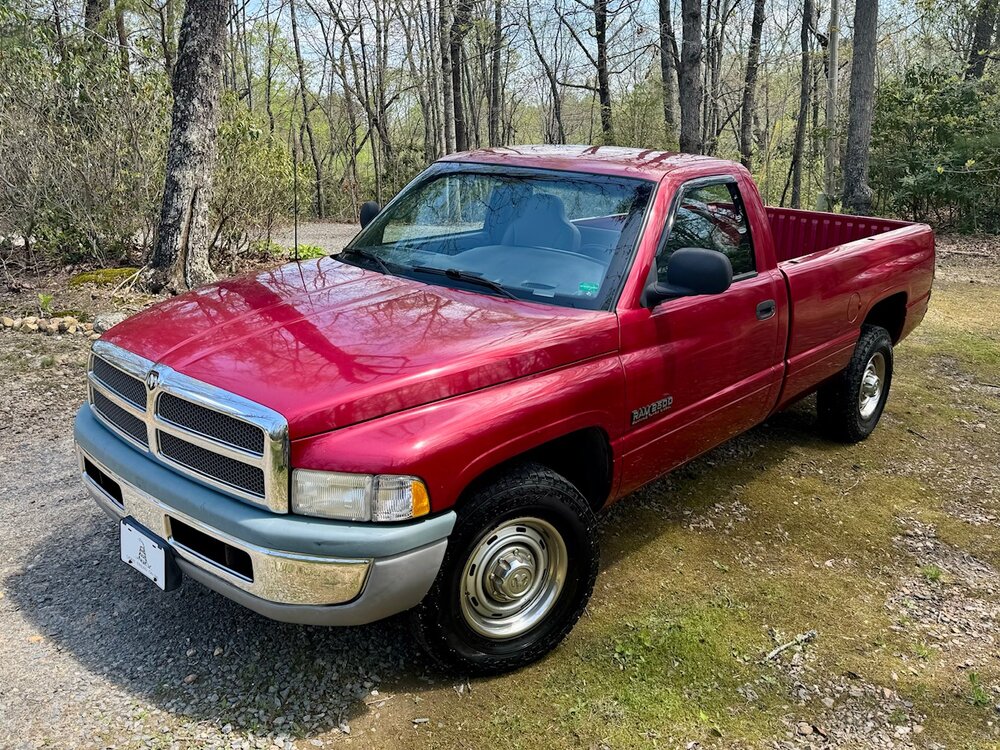

I bought a really clean 98 12v Ram from a buddy. It was his dad’s who is deceased. It is a RC 2WD.
I have some trouble when it is dry getting up my drive as it isn’t equipped with a LSD…especially with a trailer.
I want to add something to the D70 and I believe a Trutrac is the best option. The issue is they do not make one in 32spline for the D70. So to do it I need to swap to similar year 35spline D80 axle shafts.
